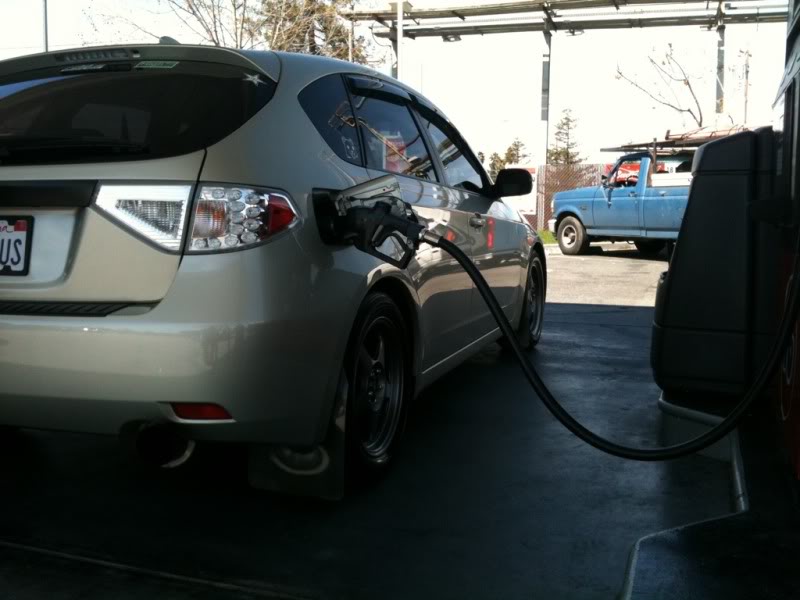

I used ⅛" Vinyl from Tap Plastics. It comes on a 12" wide roll so I made my rear flaps 15"x12" (Fronts 15"x7"). Very durable, stiff enough to be effective yet still floppy so they don't break.

Nice hatch Jourdan! Hard to see in this pic so forgive me if I'm wrong but are you rollin on slipstreams?
Old Jun 7, 2011 | 12:18 PM
JourdanWithaU's Avatar
Posts: 19,721
Indeed I am. Kickin' it old skool.
