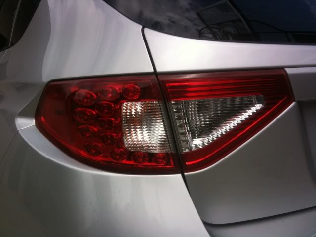

After Debating about this for a while, I thought I'd bite the bullet today since I have a lot of time on my hands. So here ya go! They are done with 4 coats of Metal Cast red and 3 coats of clear Duplicolor. The coats where extremely fine like 3 strokes from like a foot away. I let it dry for 20 then added another coat. I finished them off with buffing them with a cotton rag for like 5 minutes each. This is also after a failed attempt at overlays. Here they are!

What paint did you use exactly?
Can you tell me the brand pleaseee (:
Old Nov 16, 2010 | 12:57 PM
hwob90's Avatar
Joined: Jan 2007
Posts: 1,831
From: Walnut Creek/BayArea, CA
Car Info: 2009 WRB WRX Sedan
Krylon Stained glass red spray works great, easily found at your local Michaels store
noooooooooo!
that sh*t fades hella quick.
buy the duplicolor metalcast red like he used in this thread. comes out way better!
OP looks great. you should wetsand to get that shine back.

Mine took hella days to fade though. and the Krylon is already shiny. you could always clear to help it as well

I'm doing my lights this weekend... I have a question for those who did it. Did you guys wet sand the lights before applying any paint on them? Or should i just got ahead and paint the lights. POST ASAP!

just clean them off very well and make sure they are dry. I recommend painting them outside but if you can try to bring them inside after sprayed so they cure better like room temperature this cold temp sucks and takes forever for paint to dry. or you could always blow dry them a little too.
