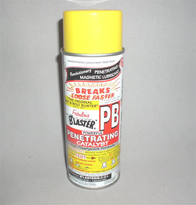

all you guys are right and the key being the PB . Did you ever get this thing on? the stock uppipe is a ***** so make sure you have the car on jackstands then use your jake to lift the motor. Do you have stock motor mounts? if you do it sould be easy if you have some group N mounts or something it makes it a little harder to work with. I have never tryed taking off one of the the bolts for the mounts but it sounds good to me. good luck and try not to forget the PB blast Name:  PB-Blaster.jpg
