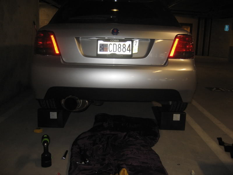

jack up or put ur car on ramps.

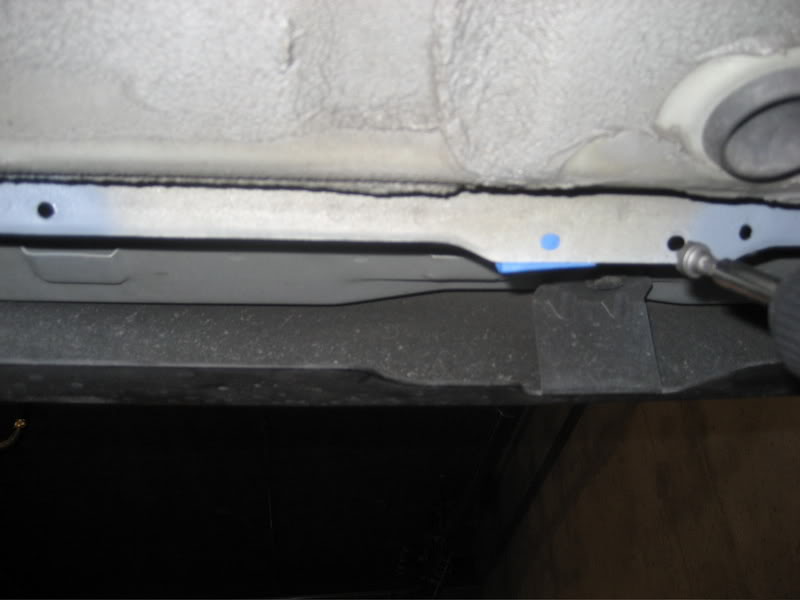

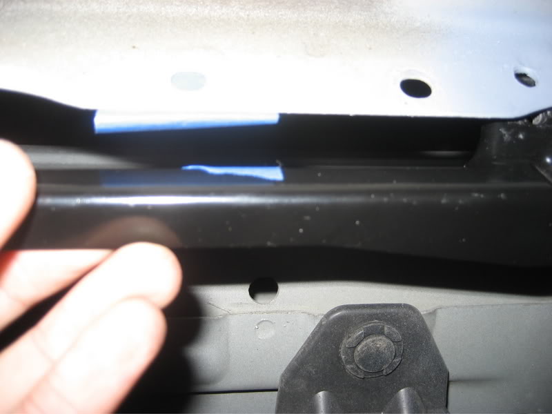

measure to the centerline of the vehicle and put a piece of tape or mark the spot
then put the bracket on the diffuser and measure to the center of the diffuser (between the four fins, not in the middle of the entire unit) and make a mark of the centerline of the bracket in perspective to the diffuser. then line up the two marks that represent the center of the car and the difffuser, and mark the two holes for mounting the bracket. then drill the holes with a 7/16" drill and deburr. also apply a spot of primer to make sure it doesnt rust.

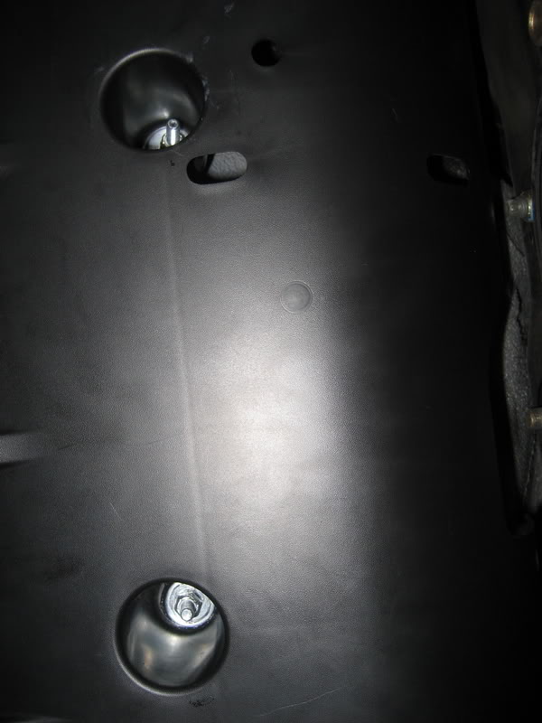

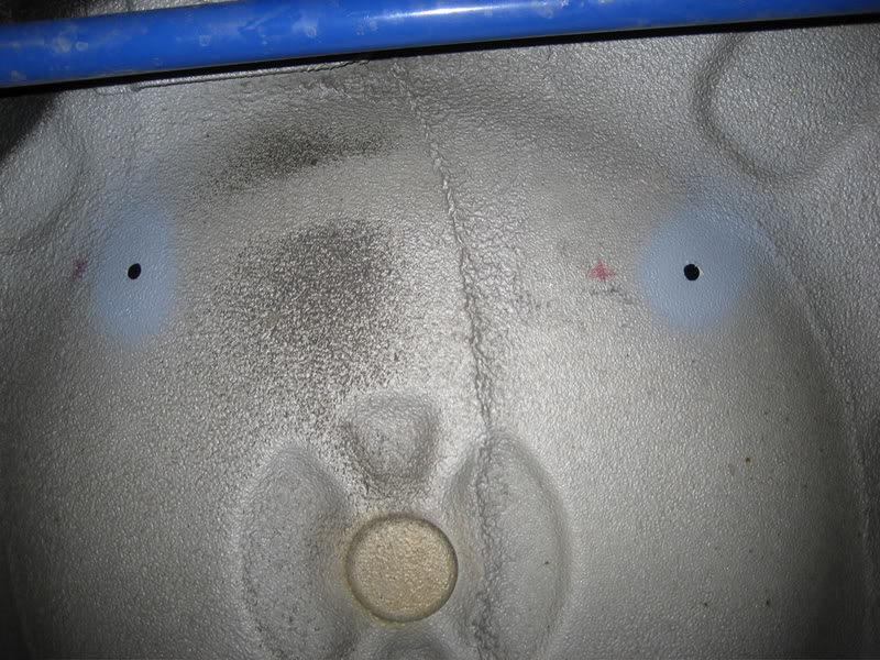

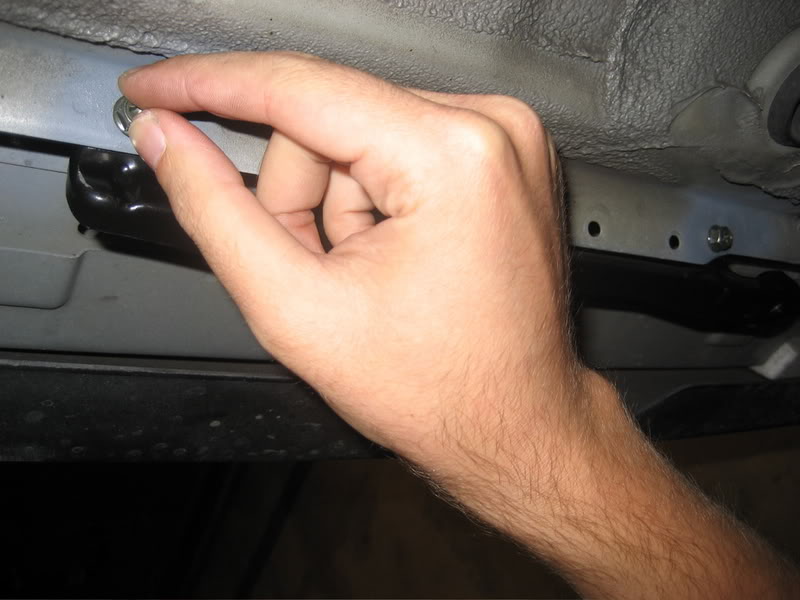

now put the diffuser on and bolt up the screws to the bracket to temporarily hold the diffuser in correct position. go under the car and push the diffuser up so it touches the underside of the car. then use a light and a pen to mark the center of the holes in the diffuser to denote the points you will have to drill. note, you only need to use the 2 forward most holes, not the single hole in the middle. take off the difffuser and take the drill and drill the two holes as shown. then deburr them and primer the holes on the inside and out (did i mention you should take your spare tire out first )

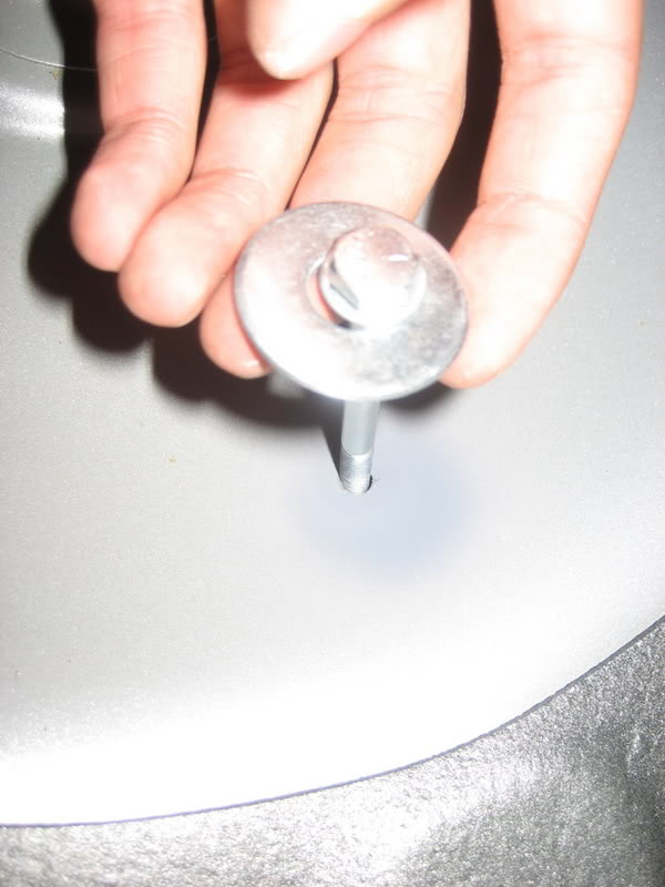

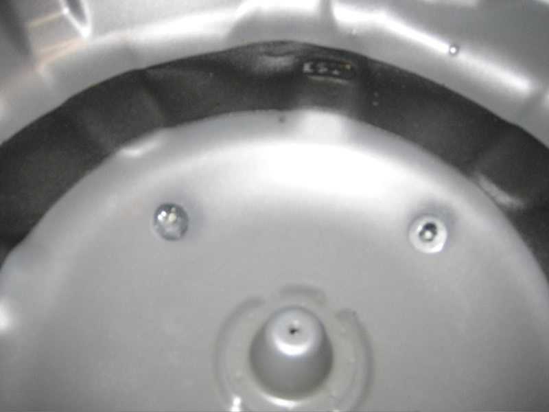

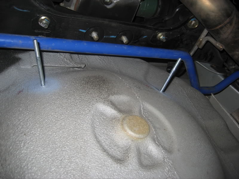

assemble the bolt that youll be using with a bolt, small washer and large washer stacked on top of each other as seen in the picture sorry its blurry. then put it through the hole. the large washer will conform to the angle of the inside of the wheel well and the second washer will fit in the center of the large washer and be more or less flat. surely there is a better way to pull this off, but this was easy and it doesnt really matter anyways. this should be strong enough and once its tightened down it will be sturdy.

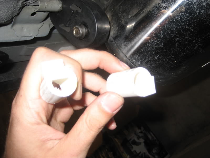

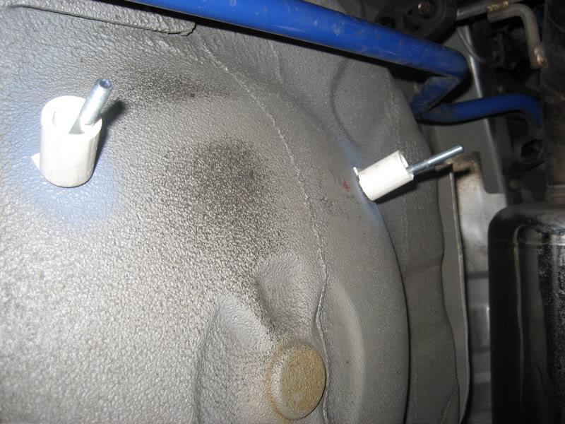

Step 5
cut two pieces of pvc pipe approximately 1.5 inches long. i used double sided tape to hold the pipe against the car as i remount the diffuser and slide the bolts through the holes in the diffuser.

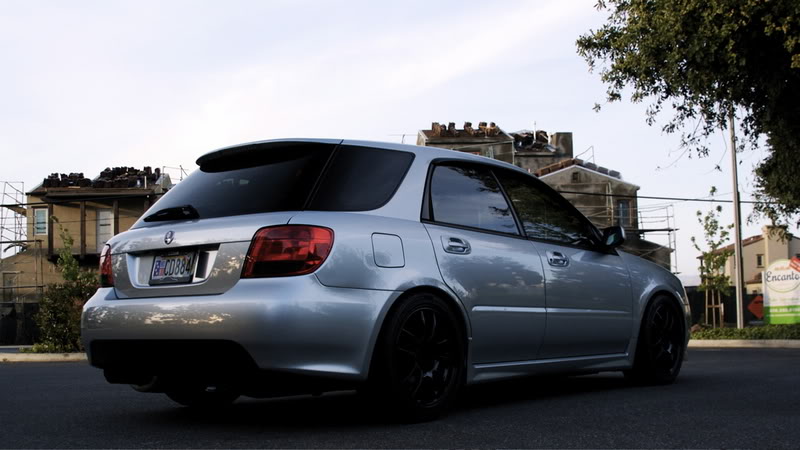

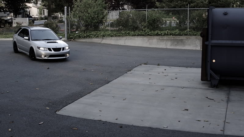

Old Sep 28, 2007 | 03:45 PM
gmodc7's Avatar
iTrader: (20)
Posts: 1,054
From: Honolulu, HI./Santa Clara, CA.
Car Info: nothing
and the "before"
linked to my thread... https://www.i-club.com/forums/bay-area-15/my-summer-07-92x-renovation-lots-pics-163339/
