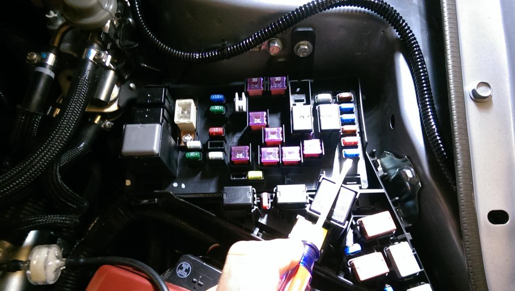

Step 1: Disable the Fuel Pump by removing the fuse (15 amp fuse, which I'm pointing at), turn on the car until it dies. Crank it one or two more times.

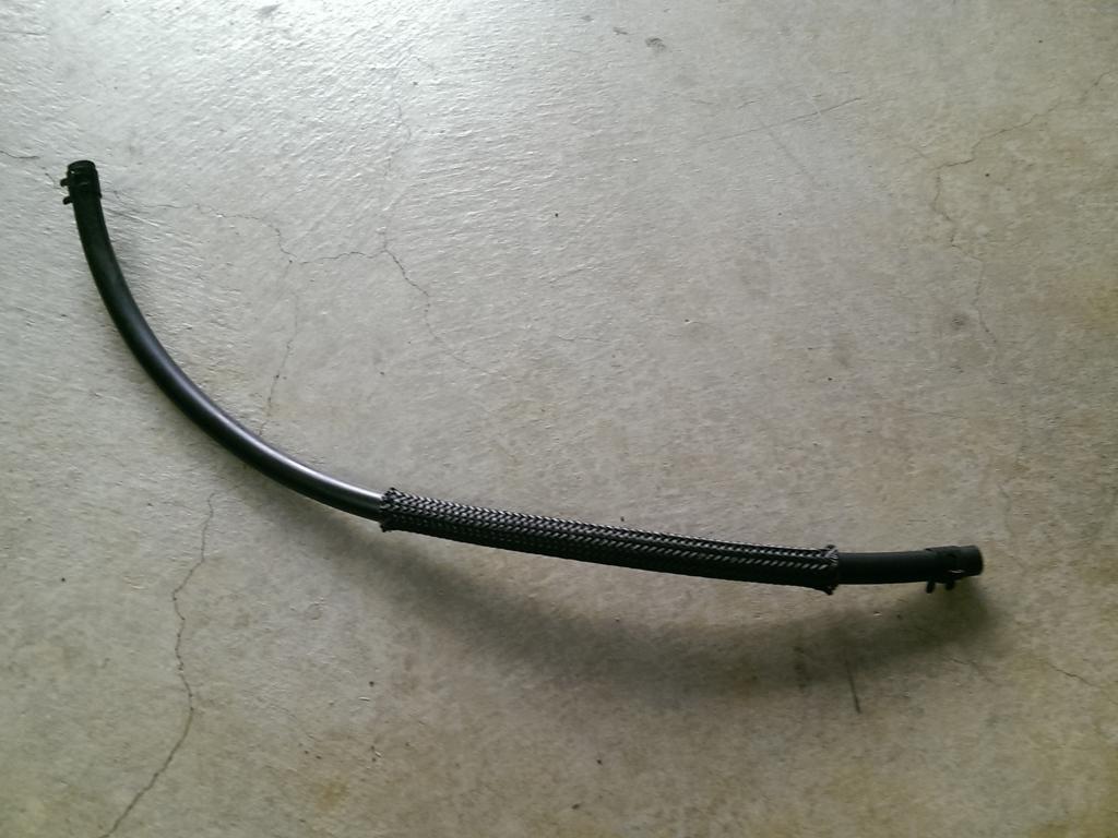

Step 6: Assemble the Feed Line - Cut one of the hoses to exactly 15 5/8 INCHES, then slide one side of the hose to the fitting. Crimp on one of the clamps at the assembled hose end. Cut the appropriate length of the braided cable sleeve which will cover the hose from clamp to clamp. Make sure you melt the edges (with a hot knife) of the braided cable sleeve to prevent it from fraying. Insert the braided cable sleeve ontop the hose, then cut two 1 inch strips of the heat shrink tubing. Insert the heat shrink tubing ontop the braided cable sleeve then insert another hose clamp. Attach another quick connect on the remaining hose end then crimp on the hose clamp. Position the braided cable sleeve in between the two hose clamps, center the heat shrink tubings so that it envelopes the clamps, then use a heat gun to shrink the tubing. The finished product will look something like below.
Note: the OEM feed line is 18 and 3/8 inches from fitting end to fitting end, the new one should be about the same or slightly longer. If you are adding the listed FUEL PRESSURE DAMPER noted above, then you need to cut the hose. The hose leading to the manifold should be 10 and 1/4 inch long, and the hose to the firewall should be 4 and a 1/2 inches long.
