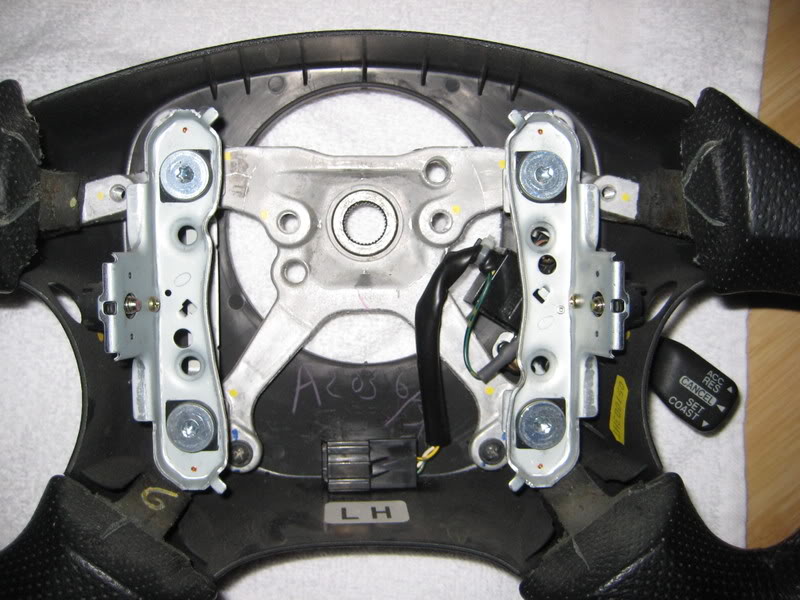

1) Follow instructions from link above to remove steering wheel.
2) Use a #30 torx bit and philips screwdriver to get the cruise control switch off your original steering wheel. Note that the metal bracket attached to the switch can be discarded.
