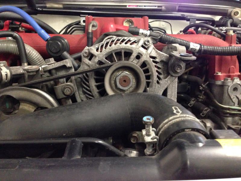

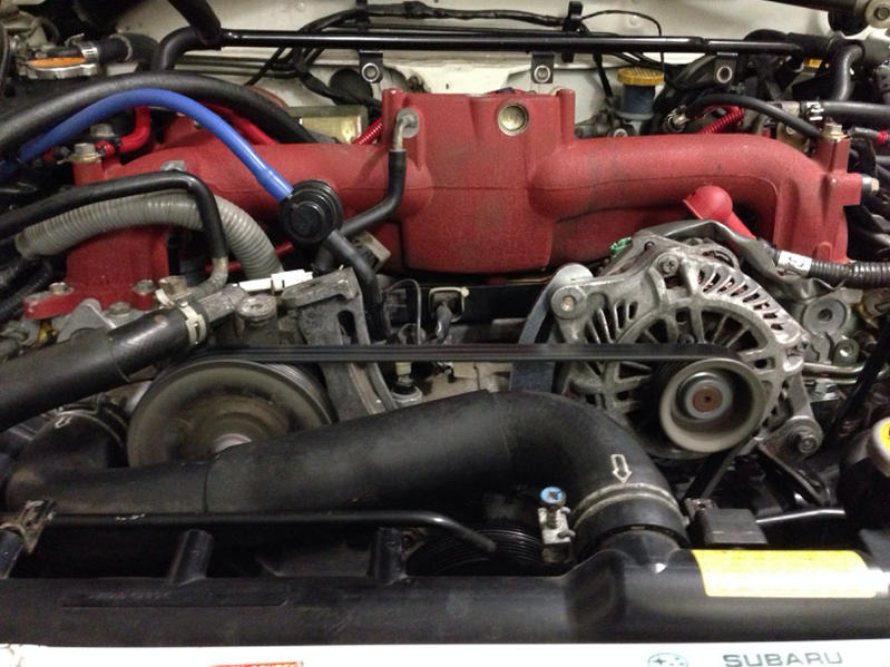

Clearing a path for the cold pipe, by relocating the alternator in preperation for rotating the intake manifold.
Before
After

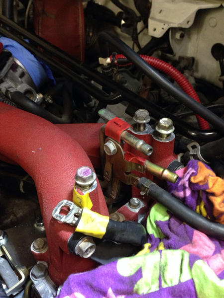

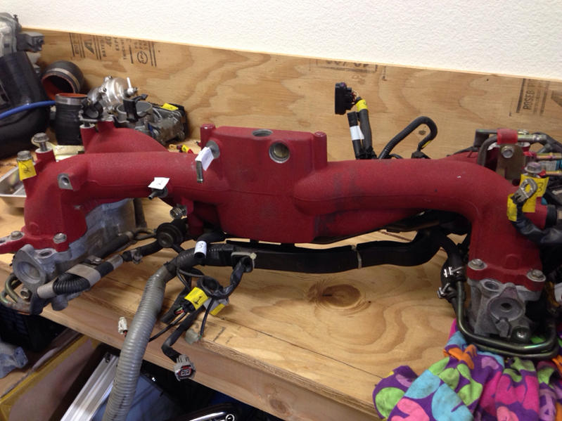

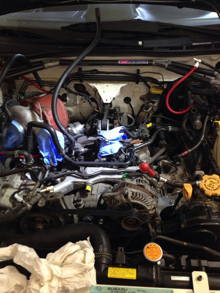

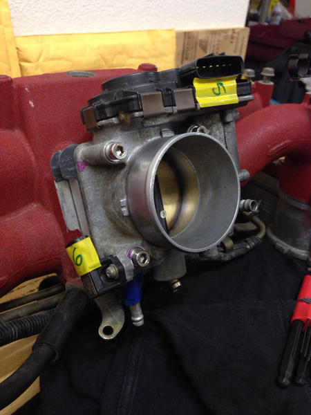

Got the manifold off this weekend and rotated the throttle body 90 degrees. Now to reroute the fuel and a few vacuum lines. I also test fitted the phenolic spacers, drivers side needs to be trimmed a bit.

Jess, any advantages to rotating the throttle body? I'm guessing in your case to free up space to run your vac/fuel lines??
Old Dec 17, 2013 | 12:24 PM
4080wrx's Avatar
Posts: 6,196
Originally Posted by reconisbologna
This is coming along nicely.. Thank goodness I didn't have to do any trimming to my phenolic spacers. Jess, any advantages to rotating the throttle body? I'm guessing in your case to free up space to run your vac/fuel lines??
I only have to trim the spacers because of the alternator relocation mount. As for rotating the TB no performance benefits, it's done to clear the alternator and for wiring and vacuum lines. I may rotate it back to the stock position if it doesn't interfere with anything.

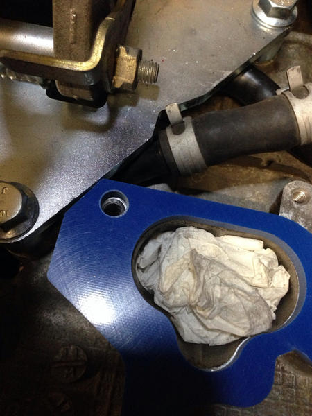

Trimmed the phelonic spacer tonight. I also cleaned off all the old gasket that was on the mounting surface. I'll go and pick up some fuel lines tomorrow and start rerouting the fuel lines to the drivers side of the manifold.
Attached Thumbnails Working on the RSTi again!!-image-3023574552.jpg   Working on the RSTi again!!-image-183863642.jpg
