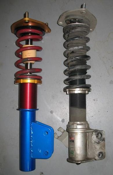

Koni 8611's with custom housings ftw....
8611's cannot control the rates I want to run.
