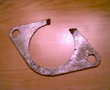

suuure... i jus finished changing mine today. i had the thicker gasket, too... but i think the loose bolt caused the leak.
Thanks again, Wes for hooking me up w/ the gasket!!

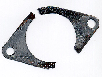

Old Jul 3, 2003 | 10:44 PM
iNfEk's Avatar
Posts: 10,455
This is all that is left...
This is all that is left of my gasket that I took off my car tonight. Damn this really sucks. At least Jeff's one is still in one piece. I lost a few pieces already hehehe
Jon

are you jus gonna unbolt the lower half of the uppipe.. or are you gonna take out everything?
Old Jul 4, 2003 | 05:09 AM
iNfEk's Avatar
Posts: 10,455
Well... I just finish replacing all the gaskets that I ordered.
I replaced the following (not necessarily in this order)
1 Turbo to Down Pipe
1 Turbo to Up Pipe
1 Up Pipe to Manifold
2 Manifold to engine
I should have bought 1 for the manifold to cross bar.
Well sucks to be me now since my EGT probe broke and now I have a bolt in there plugging the whole (or so I thought)
Will a half inch hole in the manifold (is plugged with bolt right now) cause the car not to give full boost and bog really hard if the gas if floored? If so then I'll have to fix this problem when the new probe comes in dammit!
To answer your question more clearly I had to live the Up Pipe mod experience.
In regards to the picture good thing I still had a good factory gasket still available. The leak caused my EGT probe to become brittle and break when I was installing the new gaskets
A word on the new gaskets... They are great! A lot thicker than the stock ones and gives me piece of mind knowing that It's harder for me to get a leak now.
Oh... If your going to replace your gaskets I suggest cleaning the surface of the pipes...etc. with Carb or Brake Clean to get rid of all that crap that could cause a leak.
Jon
