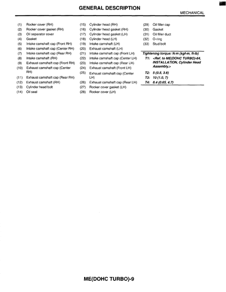

according to the 2002-2003 Subaru FSM it is supposed to be:
T2 (valve cover bolts) 5 N•m (0.5kgf-m, 3.6 ft.lbs)
please see attached
Jon
Attached Thumbnails Torque Specs-3-dohc-engine114.jpg   Torque Specs-3-dohc-engine115.jpg

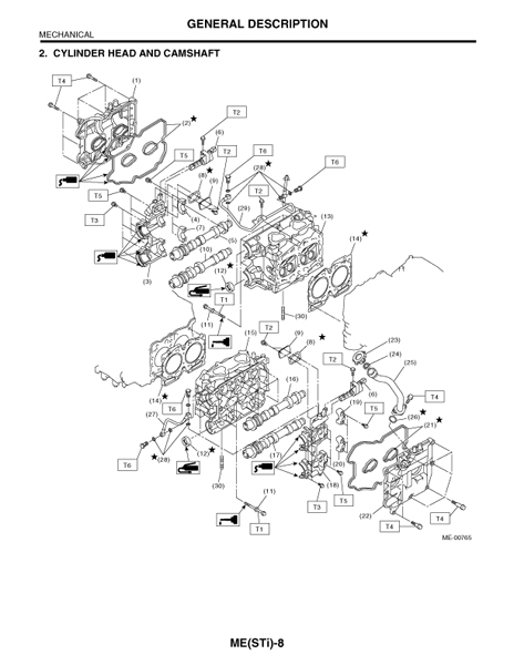

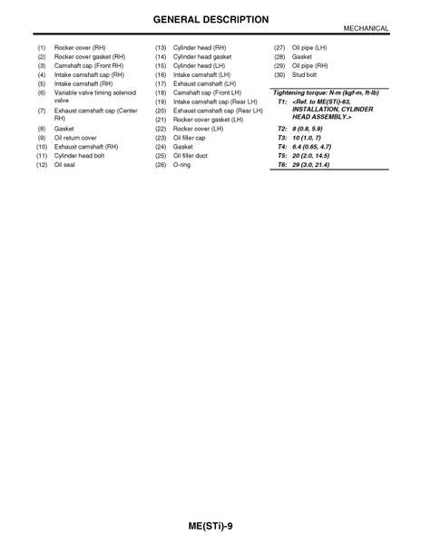

According to the STI manual the torque specs should be:
T4 (Valve Cover Bolts): 6.4 N•m (0.65 kgf-m, 4.7 ft. lbs)
Jon
