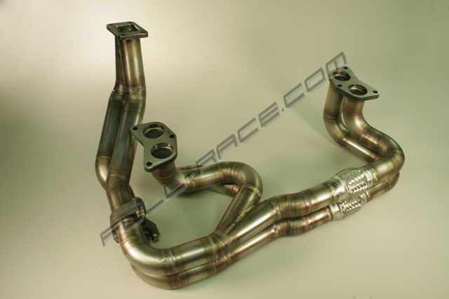

ill take the rullrace ones ooohhhhhhh nice

^^^oh yeah...
now THAT is a piece of art...look at the welds...patience is a virtue....
