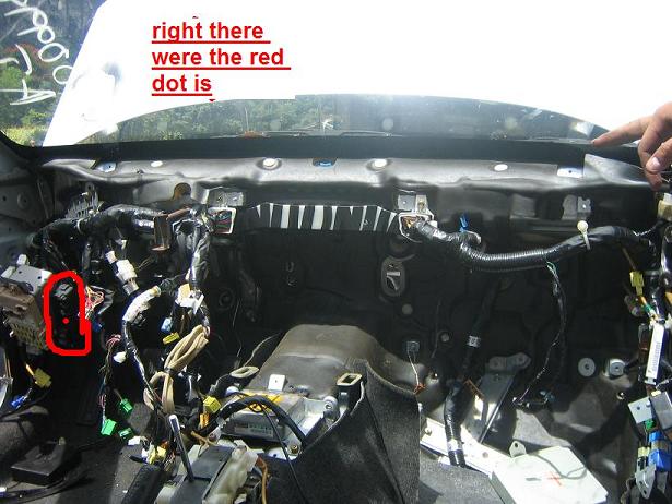

hmmm...
got everything hooked up, but nothing works...
The light on the switch comes on...but no power to the lights...hmmm...

u need the relay

Where does the relay go?
I was under the impression that STI's were plug and pray...plug in the two fogs, the switch and WALA!
Maybe not...
So where does the relay go? I have everything mounted...looks good but nothing works of course except for the nice little green light that comes on with the headlight switch...
Help me out Shaggs...man, this is becoming a PIA...

it goes here there is a slot for it here and i know on my car it comes with 3 om already and the 4th is for the fog relay

Does anyone have the fog relay?
Wow...do we have to dissasemble the lower dash to get to this? Looks like it is right next to the fuse box...hmmm...
Let me know if anyone has this relay...
Thanks for the info Shaggs...

yeh i need one to
