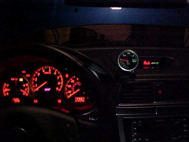

Originally posted by boloheadrat
The STi Genome boost gauge has a control unit to drive the gauge and provide peak and recording function. It is supposedly plug and play, it comes with a plug that connects to an existing harness. Apparently The USDM WRX doesn't have this harness... It's just for power and ground and stuff, but we didn't want to misidentify any wires. Now we know, so let's finish it. It must suck looking at a dark, limp gauge
So did you guys just the connector and wire up the red (power) and black (ground)?
What did you did with the white and orange wires?

What are the chances that I can hook up all 4 Defi main cable wires to the power wires to the stock clock?

This might help! This is the same image that I posted earlier that is now a red X
Jon
this is what's in the small text in the picture
RED WIRE: POWER
ORANGE WIRE: IGNITION
WHITE WIRE: ILLUMINATION
BLACK WIRE: GROUND
hope this helps!

I really need what the clock wires are..........
Old Feb 6, 2004 | 07:26 PM
  #42
iNfEk's Avatar
Posts: 10,455
Ok
look on the back of the clock they state what they are...

I have a boost gauge again!
