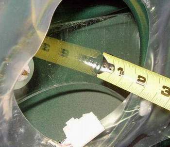

i'm running 6-1/2" up front with a spacer and 4" in the rear straight drop in. i'm not sure about the newer 04 cars but the 02-03 needs a spacer unless you have have some pretty shallow mounting depth speakers. i think the maximum is 1-3/4" without a spacer i've heard 1-7/8" somewhere too. the biggest spacer you can put without problem is a 3/4" with some shaving of the door pannel i think. i heard 1" but that is a basically almost cutting through the door pannel grill.
$150 speakers can be loud enough to hear with your windows down. it depends on what type of sound quaility you want out of it. i've heard okay ones that go loud the only thing is they need to be powered with an amp to get that type of output.
from scooby mods:
