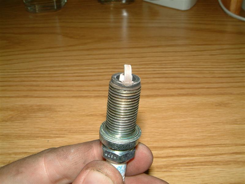

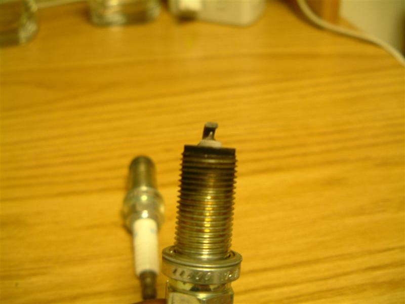

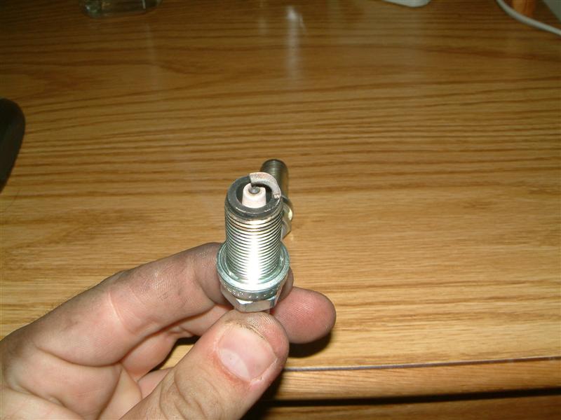

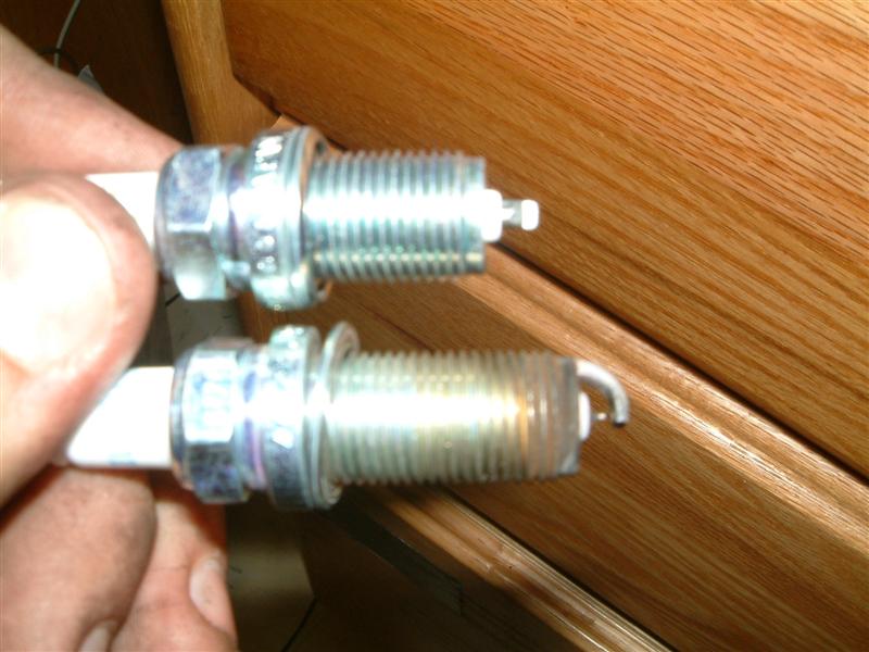

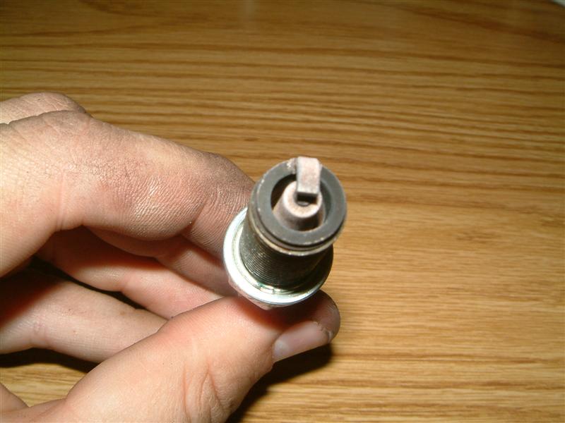

Spark Plugs
Anything Unusual?
Attached Thumbnails Spark Plugs-dscf0001-medium-.jpg   Spark Plugs-dscf0003-medium-.jpg   Spark Plugs-dscf0004-medium-.jpg   Spark Plugs-dscf0006-medium-.jpg   Spark Plugs-dscf0008-medium-.jpg
Spark Plugs-dscf0011-medium-.jpg   Spark Plugs-dscf0012-medium-.jpg   Spark Plugs-dscf0013-medium-.jpg

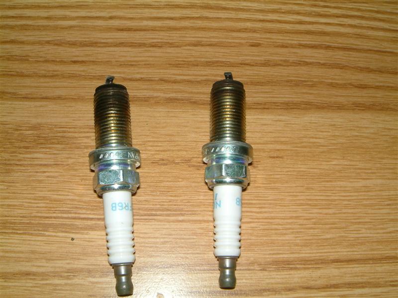

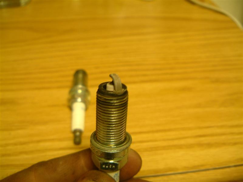

Urgent: Problem?
Hey is this a problem? Look the one plug is a lot longer than the other. I bought the plugs that are supposed to be right for the STi! The BKR7E plugs!

Are they "for" a STI or WRX?
Old Jan 19, 2005 | 01:29 AM
keirnna's Avatar
Posts: 2,659
From: Okinawa, Japan
Car Info: 1996 STI V3 Type RA
STi according to the forums.
Old Jan 19, 2005 | 01:33 AM
keirnna's Avatar
Posts: 2,659
But both STI and WRX take the same plugs.

WTF...the long one is the stock plug?
HEY...IS2Scooby should know...I read that he changed his thingies like every 5K miles!
Old Jan 19, 2005 | 11:59 AM
WRXed's Avatar
Posts: 1,568
From: somewhere
Car Info: cars
are you sure you bought the right plugs? also, are the gaps the same?

Well I installed the plugs and they work. There wasn;t really anything unusual. I am waiting to hear back if I need to use different plugs.

I just talked to NGK, and for this STI this is our plug: lfr7aix. He said that copper is not the better plug, and that it draws more power when strained. The lfr7aix is 1 stage colder, and has a copper core. I'm glad that I am everyone's test dummy, now how do I get to the parts store?

So...you got the wrong ones in there?

Don't use those short plugs Nate. I don't remember the correct PN for the STi, but you can find it on Nasioc.

Ryan, it's to ****ing late. Now I can't drive my car! No one on the island has the right plugs. I overnight ordered 8 of them from the mainland and they will be at speedgear tomorrow night.

When you come to pick them up, bing your original plugs if you still have them. I wanna check them out.
