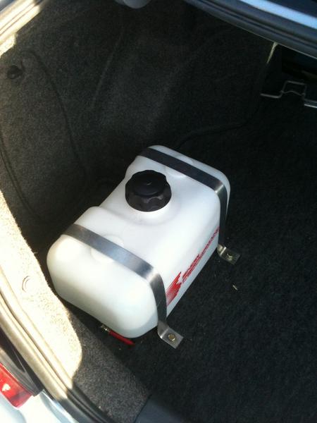

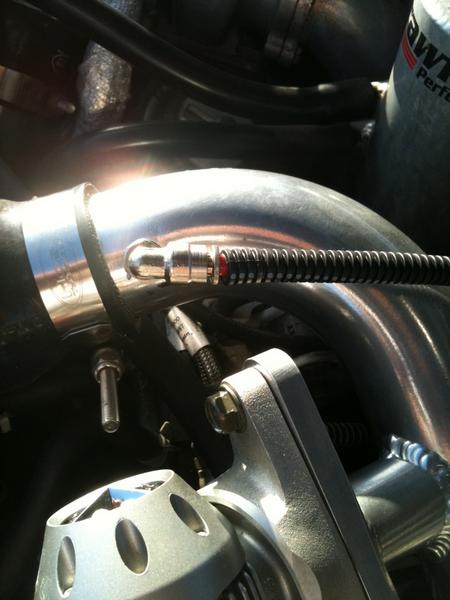

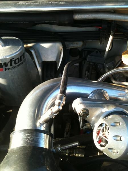

Finally , the snow performance kit's up and running . Got it set to start spraying from 11 psi and reaches full spray at 19 psi . It took awhile to install but was worth the time and effort .

I'm just using it bring down cylinder temps , but will have my tuner take a look at my data log . I've used Bill from I-speed to tune my Crawford performance gt35r turbo kit in the past . I gotta admit when the kit kicks on you can feel the response . I'm running a 60/40 water to meth ratio to be on the safe side .

I don't have a EGT gauge installed . I've used my delta-dash on my lap-top to record any data to send to my tuner . Next time I run the car I'll get a reading . I chose the snow performance because it was a simple kit to install .
