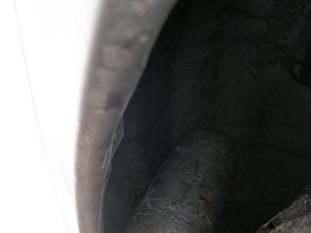

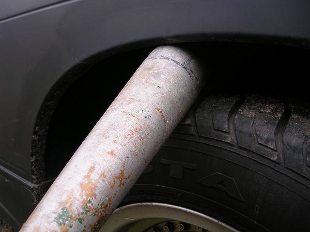

FYI on the bat...
Either end of the bat can be used (depending on how wide the gap between the tire and fender are). The [preferably wooden] bat is leveraged up behind the fender lip using the corner/sidewall of the tire as the fulcrum. You start at either side and just "roll" the bat, which in turn, flattens the inside lip of the fender. It helps to heat the paint a bit with a heat gun to minimize chipping as well. Be careful to leverage just the inner "lip" and not go so high as to dent the inside of the fender.
It's harder than it sounds.
