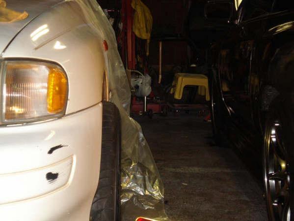

Old Apr 29, 2009 | 10:58 PM
blazerwrx's Avatar
Joined: Jul 2003
Posts: 518
From: Aloha State 808
Car Info: ~Wrong Fitment Crew~ Quest for Perfection!
Talking Pics
Yeah thats the coupe but I have 95L 4dr project!!!
here are some pics:
The bottom pics are with stock suspension and the top are with coilover, rolled and pulled fender. just have to do body work now!!
Attached Thumbnails Rim fitment.....need help on this one-rims5.jpg   Rim fitment.....need help on this one-rims6.jpg   Rim fitment.....need help on this one-rims.jpg   Rim fitment.....need help on this one-rims1.jpg
