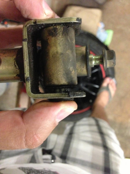

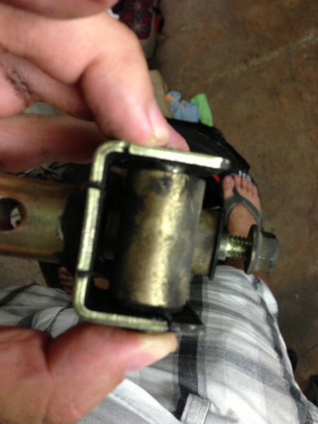

Glad your install of the linkage was smooth. I busted my knuckles and *** trying to get those babies in there.
Question: shifter slop-image-3432549980.jpg
Good thing I have tires to stand on.
Attached Thumbnails Question: shifter slop-image-1553039880.jpg

Originally Posted by PSBeachBum
....I busted my knuckles and *** trying to get those babies in there.
Yeah, I was swearing to beat hell till I figured out that if I stuck a long bolt through the fork hole I could get a pair of water pump pliers on it and give it just enough of a squeeze to spread the fork and it slipped right in. That was about 45 minutes. Next time it'll be 45 seconds.
