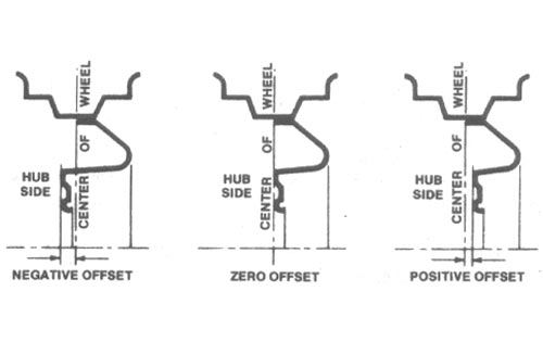

Any of you guys have a site that explains "offset" and such.. Im a tire/rim and suspension retard!
the higher the +number the more it sticks in the lower the farther out it will be

i found a helpfull pic for ya.
Attached Thumbnails Question for GC8 owners and anyone-offsetdiagram.500.jpg
