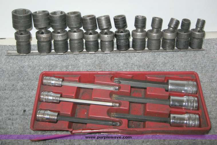

This is were the snap on swivels sockets will come in handy
