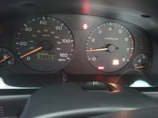

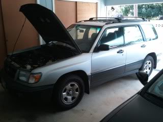

what up so i just picked up a new project since i got rid of my gc. any ways my grandpas friend has a 1998 forester that is over heating. so he bought a 2011 forester so i picked up his old one for a 100. The car has low milage and the interior and exterior is very clean. Im really thinking that it has a bad headgasket but any ways will keep u guys posted.

Old Jul 29, 2011 | 01:44 AM

Welcome to the Forester family and nice find ! If you haven't already, go check out Forester.org.
It sounds like the dreaded headgasket issue. You'll still come out ahead with the repair bill.
