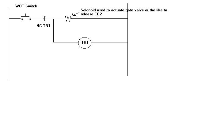

instead of capacitors, wouldnt it be a lot easier, and more convenient to use an elctric timer? they sell 12volt timers that are adjustable from like 0-20 seconds, you could wire it something like this
edit:just to clear it up, the contact opens after the timer has gone through its time, say 2 sec. it will stay closed until time is up then it will open. you can have a master switch before all of this too, just didnt draw it.
with capacitors, they will be charged even with the car off, so you will have to be careful working around them too. you can put a light to know when co2 is spraying in parallel with the solenoid. let me know if i am forgetting something or not understanding. just thought it would be easier and simpler than using capacitors. and you can adjust the amount of spray you get at any time. you could also get crazy and use some logic controls, when in first co2 fires for 1 sec, then in second gear 2 second burst, in 3rd 6 sec, so on, so on.
hey dude... maybe I'm missing something.... but shouldn't the contact only drop power to the solenoid and not the timer too?
I might be misunderstanding your timing relay... does it automatically reset too?

its an electronic relay. when power is applied to it, it starts timing, if power is dropped out while it is timing, it resets the time and waits for power to be applied again. when power is applied and the timer times out the full 2 seconds(or whatever its set at) then it cuts power to the sprayer, not letting it be on for more than 2 seconds. and after power is dropped, it resets back to zero to wait for power to be applied again and start the cycle over again.
on second thought, while typing this. the way i have it wired, it will blow CO2 whenever at WOT, but not longer than 2 seconds at a time. it will go for any amount of time you are at WOT, under 2 seconds. why not just have it go for the whole time while at WOT?
just re-read first few posts, under 2 seconds to conserve CO2. but why? doesnt the air coming through the intercooler get used after 2 seconds are up? you will have cold, dense air for 2 seconds, then it will be back to warm air. but you are only in each gear for a limited amount of time, and the air after __ seconds will just be put out the BOV, right? i am kind of new to the turbo scene. i know the basics and theories of it, but have little hands on experience.

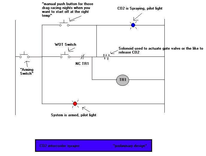

updated wiring diagram, so messy, all i have is paint
