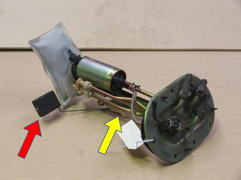

See attached photo. The one pictured is from a GC but it has the same basic concept. I'd be willing to bet the sensor is just aging and second something could have possibly bent the rod which supports the floater. But unless you haven't been in there lately to accidentally damage the leveler I would go with the sensor being bad.
Yellow arrow=sensor
Red arrow=leveler/floater

the contacts for the fuel pump and leveler are probably dirty from the crappy fuel we have here. take it out and clean the contacts. Since you're in there replace the fuel filter. The picture that Jess posted is what our fuel pump looks like. The black square is the leveler. The other end is where the contacts are. I had this same problem about a year back. Once cleaned the problem didn't come back.
