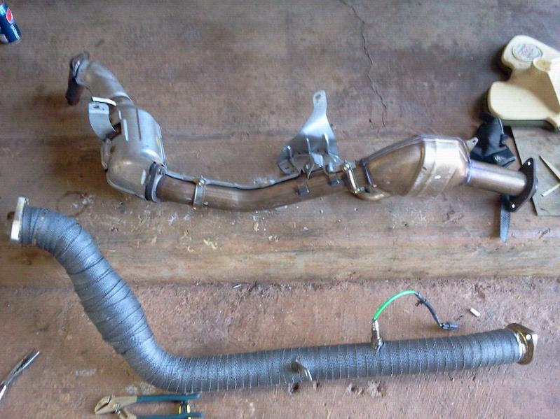

Old Jan 14, 2013 | 09:52 AM
Daddyz808's Avatar
Joined: Aug 2012
Posts: 30
Did mines this weekend...turned out great
