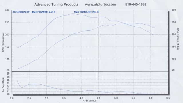

Look at this graph.
This is one of the other reasons I chose Ludespeed.
285 ftlb of Torque @ 3700RPM!!! Holy Shtick! and 245HP! This is at the wheels gentlemen!

What turbo kit/engine management are they using?
Is that the stage 2 w/ link?

stage III Ludespeed (yes with Link) and bigger injectors and borla headers.
That's pretty much it.
And I won't be out very often at the drags. RS trannys just can't hang. I don't think my exedy clutch will last long if I do.

he's makin' it right now
My deposit is already paid.
I'm getting a catless system with a 3" downpipe instead of the 2.5"
I'm getting the 4.5lb and 6.5lb springs (to facilitate tuning as I get things hashed out). When the link comes (month or so) I'll be pushing 10lbs. When my injectors come in it'll be around 12lbs and VERY Similar to the graph above. Only I'll have Cams and a FMIC. That should give me a more noticeable amount of ponies.
Bigger turbo, SS up and down, 255L/hr fuel pump, parallel fuel rail mod, etc etc. are all on their way also.
I won't be pulling 12.6's, but I'll be low 13's of not high 12's.

that sounds cool but might as well order a new clutch now the exedy wonmt handle anwhere near that then might as well make sure the card is paid off because i dont give your trans too long

that thing runs hella rich in the top after 5.5k it goes off the chart

D, I know that's crazy rich!
I wonder if the power would fall off that much up top if the mixtures stayed closer to 11:1

I think there's that much fuel b/c that's what happens when injectors get stuck wide open at 100% duty cycle!! J/K!
really though, ... maybe pouring in fuel to fight off detonation? That's on a stock block and internals, right?
