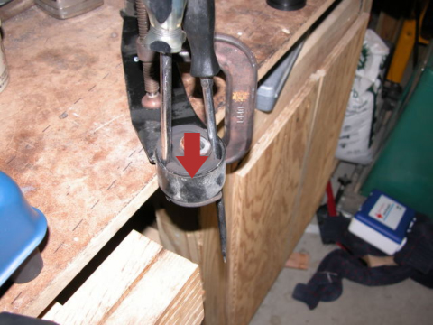

The only thing that I would change between the install that they posted and how I did it was the way that I removed the Bushings from the Differential Bracket that holds them.
In their install they use 2 screw drivers and a hammer. I started to use that method and ended up doing something different.
- Their method I took longer than 5 minutes and I still hadn't taken them out yet
Instead of putting the two screw drivers where they had it I just put 1 screw driver on the furtherest side of the bracket (closest part in the picture) and make sure that the end of the flat head screw driver is protruding outside the other end agains the bracket. then I got a small sledge hammer (all I had) and gave it two nice wacks and the pushing came out as the screw driver head went further down. It is best to use a medium size flat head screw driver.
- My method (2 minutes for both sides)
If you follow their install it will be very easy!
