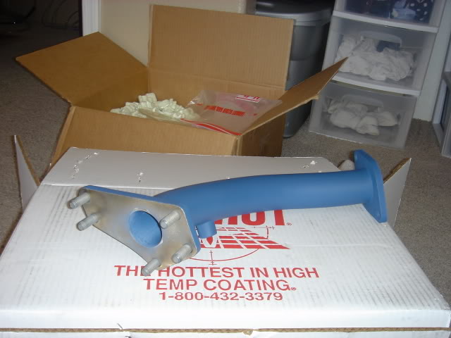

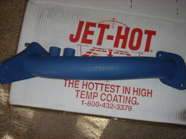

i Jet-Hotted my Cobb 304 stainless Up pipe with jet hot's ulta hight temp stuff.. i believe its called 2000.
if i could, i would jet hot everything pre turbo side every time. the quality, protection and gains are worth it. keeps more thermal energy in the pipes.. = more energy going into your turbo. keeps pipes from rusting.. especially here in HI. they do a quality job and keep dibs on the order status very professionally.
i got mine done in cobb blue!
go for it.

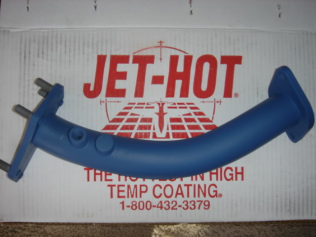

Old Sep 30, 2007 | 02:15 PM
BugeyeMilo's Avatar
Joined: Jul 2007
Posts: 209
From: RUBIN'S GARAGE - Do Work!
Car Info: 05 Aspen White STi 02 PSM Bugeye RIP

very, very good point Mister. thats why i went with Jet Hot's 2000 coating. most ceramics simply cannot withstand repeated use with the high egt's the pre turbo parts see in a WRX or STi.
very important to check the temp ratings and inside/outside coating options of your ceramic coater before you purcase.
i cannot reccomend JET HOT enough. give em a try i guarntee you wont be disappointed.
you can see the inside coating of my uppipe in one of those pics.
very nicely done.
