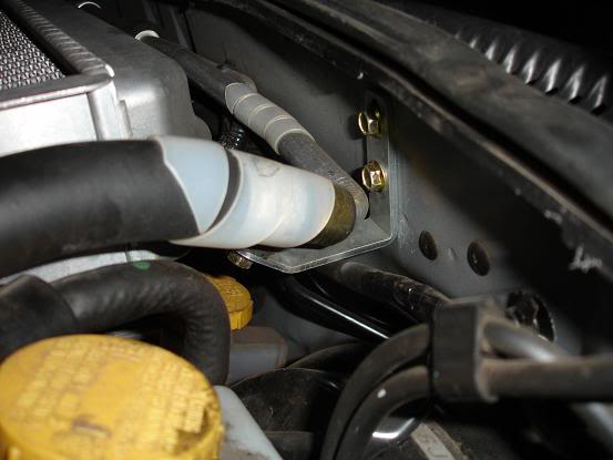

my cusco strut bar came with this bracket. i dont think too many people have it.... i also had to push my a/c line down as well.
you can fab one up easy with some materials from home depot racing . i made one for islandstyle, not sure if hes running it tho..

^^^I'm running the custom fab..
Thanks to Jimi, I have a bracket almost identical to the one you see above...very nice custom job!
