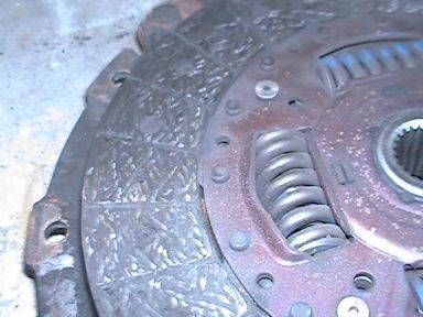

wouldn't let me link the pic.
OBTW, that is a v7 clutch. They guy is also selling the v7 flywheel as well.
Could someone give me their opinion today so I can tell him yea or nay?
