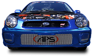

I got your back! When do we start?
Oh I want one of these kits as soon as they come out.....70 more flywheel HP here I come!
http://www.airpowersystems.com.au/us...i_370_usa.html
Attached Thumbnails I think I'm going to install something on my car...but it's a secret.-low_front.gif
