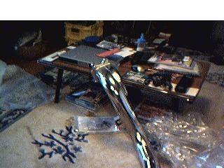

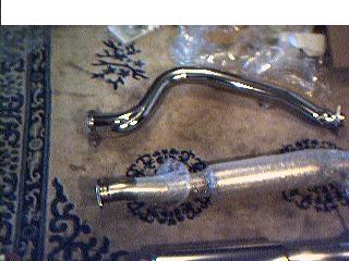

Alex's Cusco....divorced wastegate, bellmouth, course I'm biased as I run the cusco as well.
Old Jul 3, 2003 | 03:37 AM
islandx's Avatar
Posts: 1,527
From: Anti-___
Old Jul 3, 2003 | 03:40 AM
islandx's Avatar
Posts: 1,527
From: Anti-___
