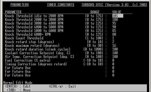

The UTEC does that. Not per cylinder, but for all 4. It can disregard knock, what 'threshold' you want, how much duration...
You get the picture.
