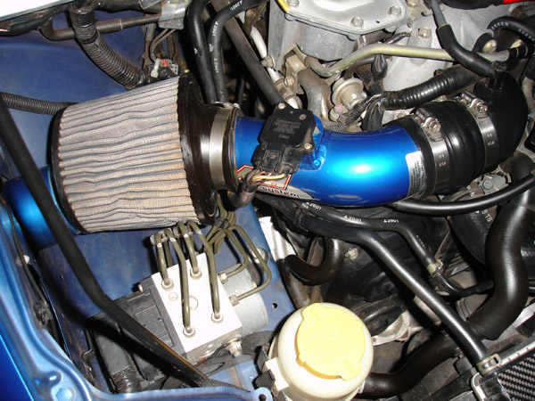

-AEM intake

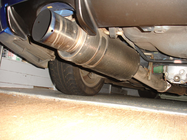

-3in turboback with cat, not sure of the brand

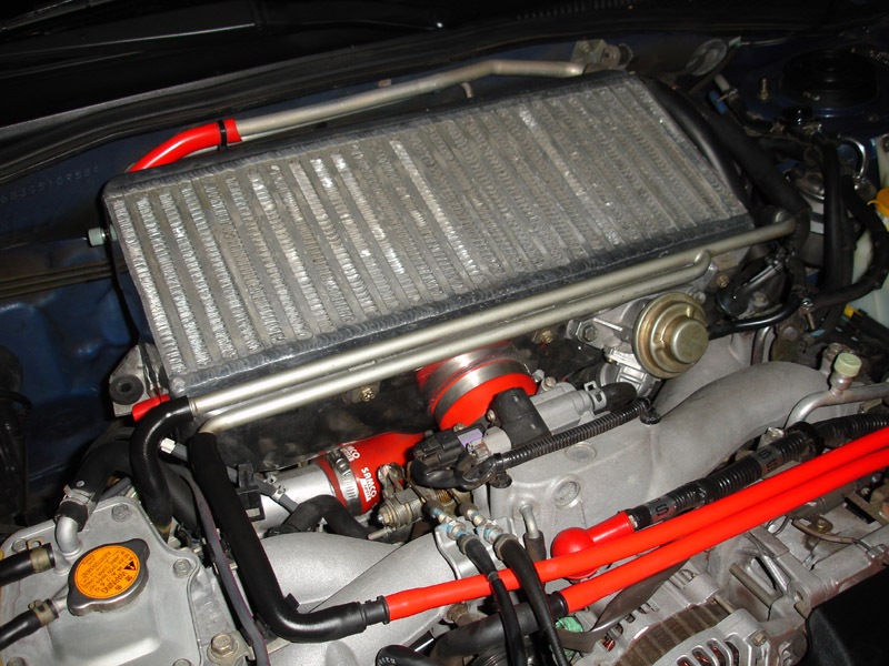

-larger top mount intercooler again not positive of the brand

first off remove your AEM intake that can cause your car to run leaner than normal. Is it a CAI or a regular SRI?
Have you reset the computer rather than clearing the code? The larger top mount will also cause you to run leaner without a proper tune. same goes for the intake.

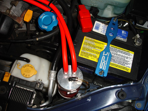

how is your catch can installed. please post pictures. if it is installed wrong that can lean out your engine as well.

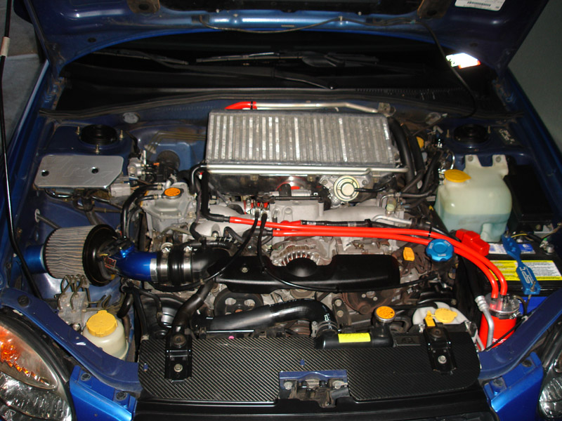

its been properly reset twice by the OBD scanners and a couple times by doin the battery thing. i dont have the origional parts to swap out, this is how i bought the car. i dont think there is anything really wrong, i think it just needs a tune. here are some pics.
Attached Thumbnails grrrrrr.......-1.jpg   grrrrrr.......-2.jpg   grrrrrr.......-3.jpg   grrrrrr.......-4.jpg   grrrrrr.......-6.jpg

the fact that your ECU is sending a CEL is telling you that there IS something wrong. yes, you do need a tune in order to properly run the things you have on the car now. The accessport was NOT designed to run with an intake. They recommend you run the factory air box since intake systems cause inconsistant MAF readings. Technically there is NOTHING wrong with the setup just the fact that your ECU doesn't know how to handle the readings it's getting from your engine setup. The stock ECU has a set of parameters and since you're getting a CEL code or more than 1 CEL code means that they are either above or below the valid parameters. In your case it's probably below. Lean means that your engine is getting TO MUCH AIR to fuel.
