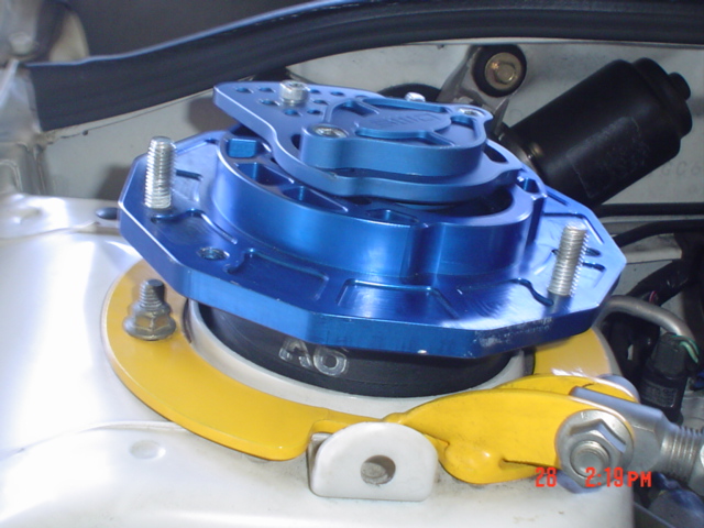

hey guys
just found out from a member on NASIOC that the front tophats from the 02+ WRX and my GC8 are the same...that means that Mike's camber caster plates should bolt right up...baaaahhh wish i knew this earlier...what do you guys think?...i got some pics on the plates with my existing tophats...looks like a fit? thanks
Hugh

here is what it suppose to look like installed...
Old Feb 28, 2005 | 04:22 PM
Huby's Avatar
Posts: 553
From: tropical island
looks like the caster is pointed in the wrong direction? pointed downward away from the engine...

damn dude... had we known that... well that's good news for you... you don't have to waste money on the V6 STI tophats and you don't have to take apart your exsisting setup to get the top hats you need... also you got FREE caster adjusters :banana:
Install them... but I would take off one side of the front just to see if it fits correctly
