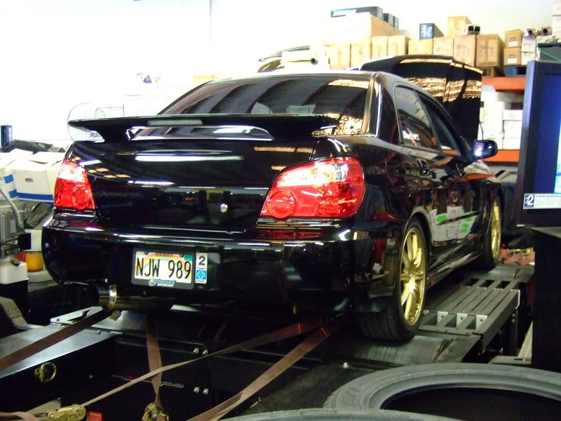

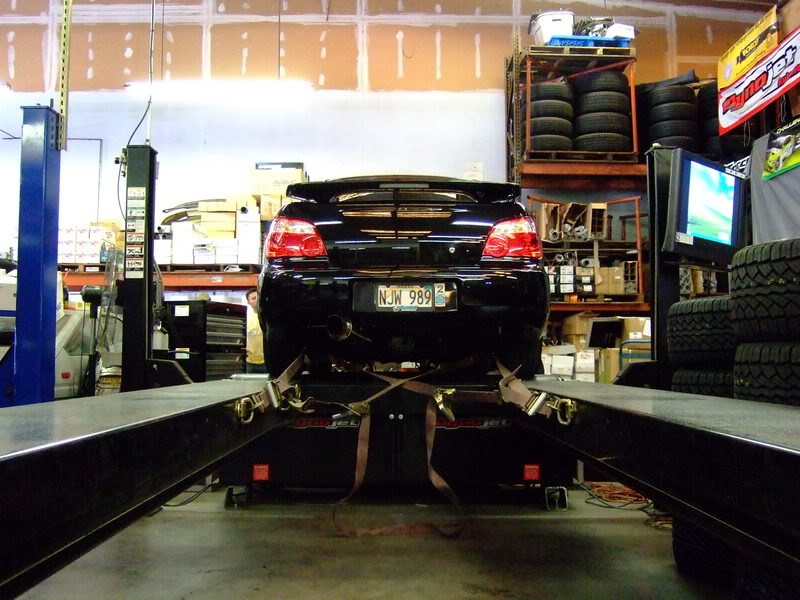

Here's some pictures I took.....I'm still waiting for the videos to upload.
