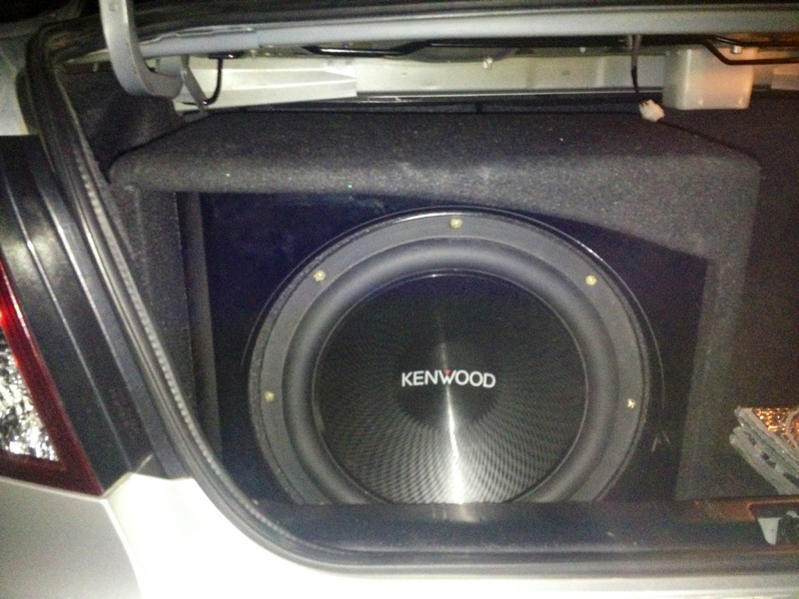

Originally Posted by Ross
I want to mount a small sub in the trunk but I'm worried about drilling holes in the trunk floor. Is there anything I can damage if I'm not careful? Looking at the service manual, it seems that the gas tank is pretty far forward, near the rear seats - is this correct? Anything else I should be aware of before I start making holes in the trunk? Thanks.
I took out my upper liner and drilled 2 holes out and ran a nut and bolt with a washer then into the subwoofer using a L bracket. I'll take pics for you in a bit.

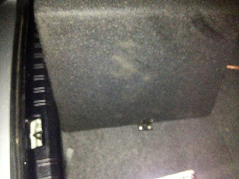

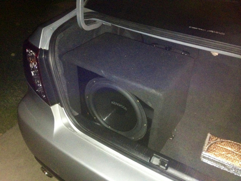

Here's how I did mine with a 12".
Attached Thumbnails Drilling in trunk to mount a sub?-image-2133297434.jpg   Drilling in trunk to mount a sub?-image-2905271232.jpg   Drilling in trunk to mount a sub?-image-4178879912.jpg   Drilling in trunk to mount a sub?-image-806050308.jpg
exactly what i did with mine.. i have only a 10" and mounted it more towards the rear seats. i drilled holes in the through the upper liner and using 2 L brackets and some small screws drilled it in.. did this about a year ago and still all is sturdy and works fine. not sure about the quick release, but sounds like a good idea!
