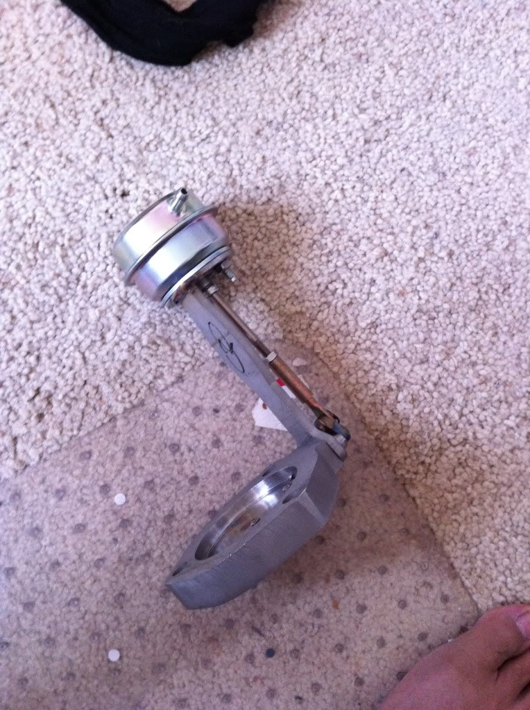

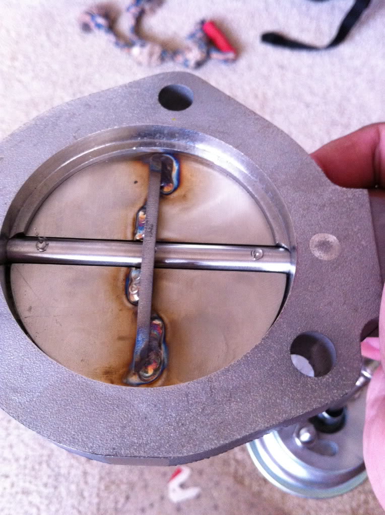

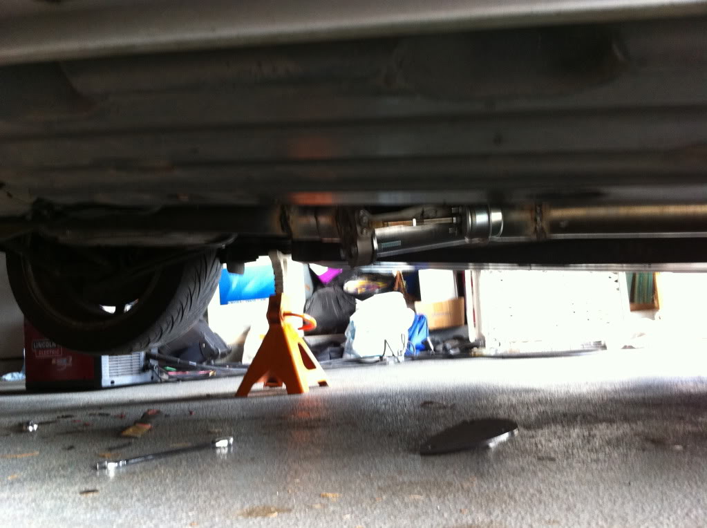

I've had this idea for a long time, so I convinced another Iclub member to try it out. I sent him the links for all the parts, convinced him that he would have more sex if he listened to my idea, then and we fabbed it at my house.

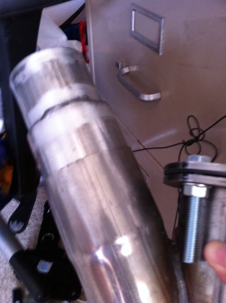

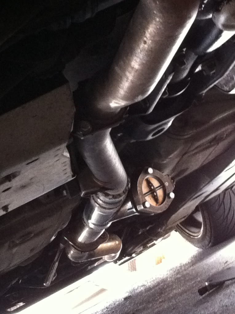

It's basically a stealthback, catfree downpipe with a cutout that bypasses the muffler. We both thought about placing the cutout on downpipe itself, but just in case he went rotated I thought it would be cheaper to make a midpipe than to cut up a downpipe.
The cutout is boost activated and open very fast. Yes it requires tuning.
It goes from dead silent to obnoxious in a split second, and you can turn it off if you want by placing a solenoid inline. Or you could just keep your foot off the throttle. Because it's still a stealthback, it's not as restrictive as the stock system. It likely won't outflow a really good 3" system, but it's a lot more stealth. It's also loud when you want it to be. On the road dyno, the car showed some gains over a 3" system, but it was a crappy Ebay 3" catback, so I wouldn't consider it conclusive. The car has a good feel to it, and I could turn the boost up in the lower gears with very little knock. The car is dead silent around town and even at part throttle boost.

Just know that the purpose of this is NOT to make more power than an aftermarket catback. It's really just so that you can run something quieter and make the power of a louder/bigger more free-flowing catback without the constant noise.

BTW I didn't make the cutout. It's from SP racing and is not cheap, but it's a solid piece that I don't think will fail. My friend may send me more vids.
I know that the car took a bit more timing with this setup, so I know he's making more power, and I know he's happy with it.
