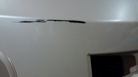

Some dude scraped my bumper while I was getting some dinner, sad days . Not sure if I should go through my insurance or just pay outta pocket. I did a search and heard Oka's is good so I hope to take it there. Anybody know if insurance companies allow you to choose which shop to take it to?

That's going to be under $500 to fix.

Should be $250-300 to paint the bumper.

I hope so. I know nothing of painting. Do they have to repaint the whole bumper or just the damaged area?

being a new car, should be pretty easy to just paint the area. You color has started fading or discoloring yet so paint straight from the factory should be almost a 100% match with very little work required to make it match perfect.

I'd venture to say that the repairs would just slightly exceed $500, maybe close to $600. It's a 3 stage and even though the body labor is small, there are a lot of small parts that we would have to remove and possibly paint too (fog cover, Tow hook cover, etc..).

Typically, we will complete the body work and primer. The base and mica coat would have to cover the primer, and typically gets feathered out onto the rest of the bumper. The entire bumper is cleared and baked though.

Unfortunately, it's not quite as easy as we would hope, but I wish it was. Color matching is difficult even with solid colors like Aspen White. Metallic and Tri coats are very difficult to match.......on a new car or older. However you are partially true about it being a little easier because the car is newer. I tell all of our customers that painting and color matching is one of the hardest parts of our job, and at the same time, it's the most visible too. We're very up front and honest about what we do and we make no promises. I'd love the opportunity to help a fellow Suby enthusiast out, but if it's a 100% match you're expecting, our shop cannot guarantee it. Many of the fellow members can vouch for the work and the service you'll receive, but a dead on butt match on a bumper with a 3 stage pearl.........that's a tough one. It's just that you're dealing with different density materials (plastic vs. metal), so the panels will reflect color differently. Then you add in the 3 stage part of it....... If you have any questions or want to set up an estimate, call me at the shop # 677-5474 ext. 11 and ask for Brandon. We can talk story and I can explain your options.

you could prolly get the whole bumper painted for less than 500... get the whole thing done just to replace the crap paint from subaru
