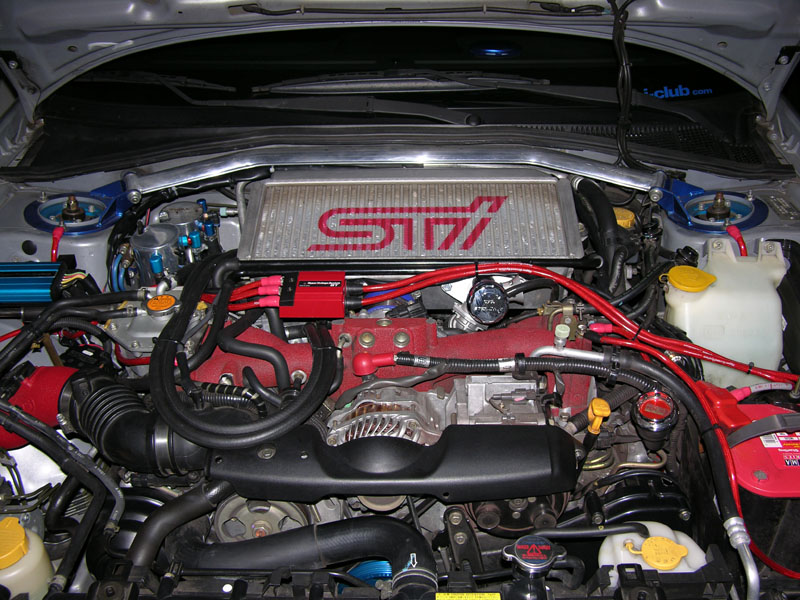

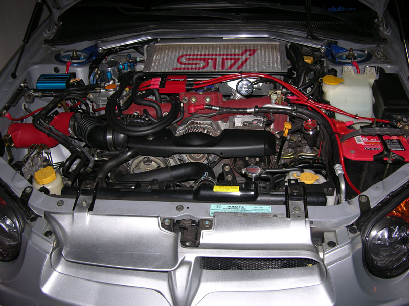

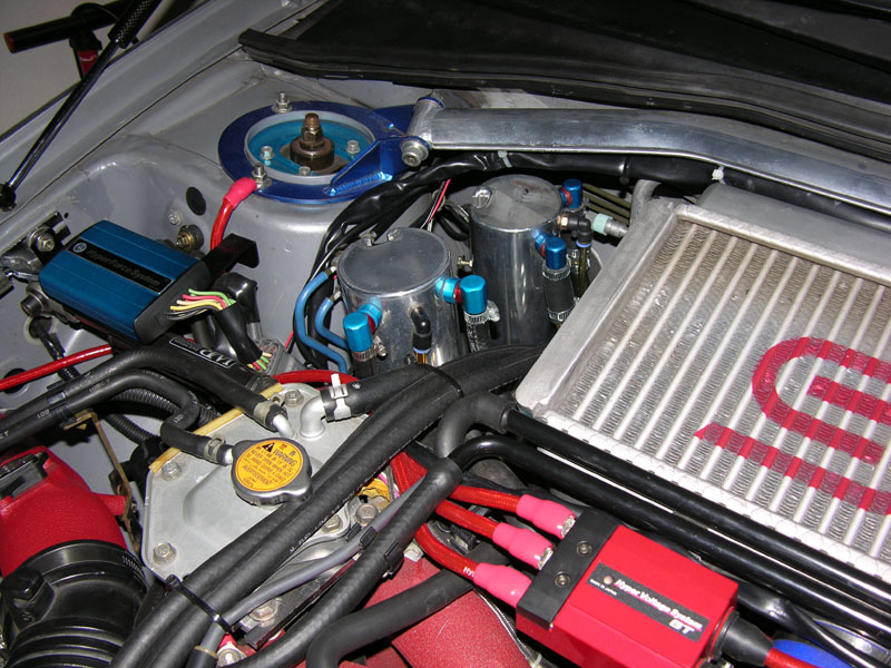

Hey...thanks to Jon for bringing up the fact that two catch cans were really necessary on an STI to filter out the oil from the intake tract...and Brad for providing me with the second Cusco catch can...
After a few searches on I-Club, NASIOC, and IWSTI...with links provided by Ojichan STI and Bran808...I came up with the following install today...I had to use a bracket to attach the catch can lower along the strut tower and relocate my alarm horn...but it all came out clean and everything works great...
Here are some pics:
Attached Thumbnails Cusco Dual Oil Catch Can Setup...-dscn2706.jpg   Cusco Dual Oil Catch Can Setup...-dscn2707.jpg   Cusco Dual Oil Catch Can Setup...-dscn2708.jpg   Cusco Dual Oil Catch Can Setup...-dscn2709.jpg   Cusco Dual Oil Catch Can Setup...-dscn2710.jpg

Ya Roy...it's cool...just need to get a bunch of metal brackets to see which works the best...
I luckily found one that worked perfectly..I even bent it around the strut tower...you need to see this...

Why two catch cans ?
Are they run in series, one after another ?
Or are they filtering from two different points.
Old Dec 21, 2006 | 12:48 AM
Island Style's Avatar
iTrader: (66)
Posts: 3,615
From: Windward, Oahu
no...they are not in series,
they are filtering two different points...
1) PCV
2) Crankcase
I'm running two oil catch cans now to keep the PCV and crankcase ventilations separate. They both dump back into the intake eventually though, with or without catch cans...

Cool, it looks really good. Ive been wanting to pick up a cusco catch can for a while now. I have one question though how do u know when the can is full? is there a window to see in?
Old Dec 21, 2006 | 04:37 PM
rtakashi's Avatar
Joined: Sep 2004
Posts: 1,333
From: hawaii: i gotta wash my car!
Car Info: 2005 wrx
^^there's a clear tube on the side of catch can, that you can see the level
