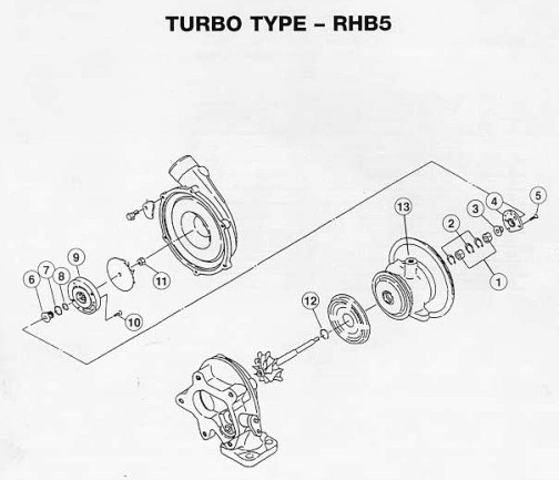

Sigh. Anybody know which part failed on my VF30?
__________________
Old Dec 22, 2002 | 03:20 PM
Nolimit's Avatar
Where is my beer?
Posts: 4,677
From: San Diego
Car Info: NSX, G35
it'd probably have to be disassembled to find out exactly what didn't seal.
