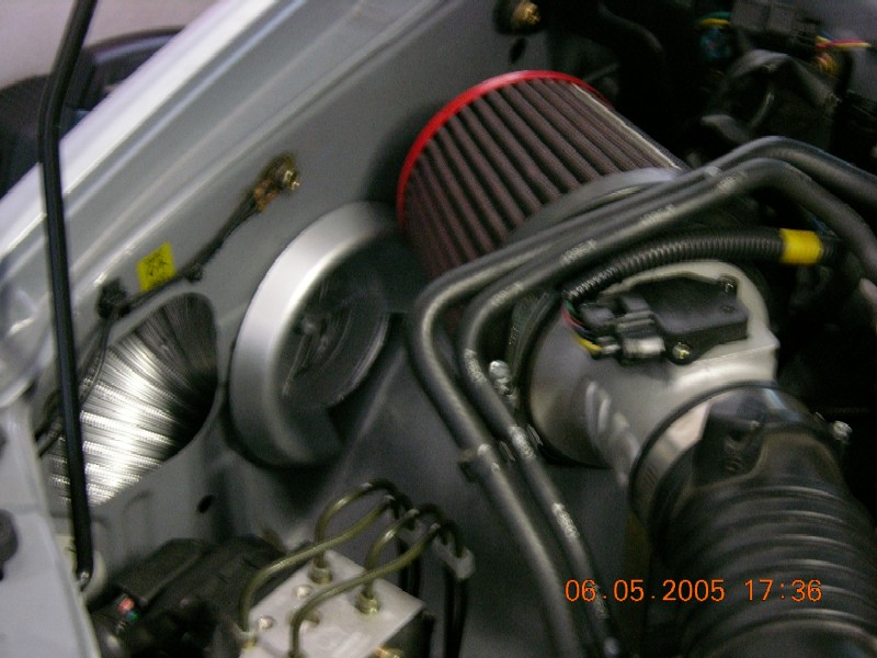

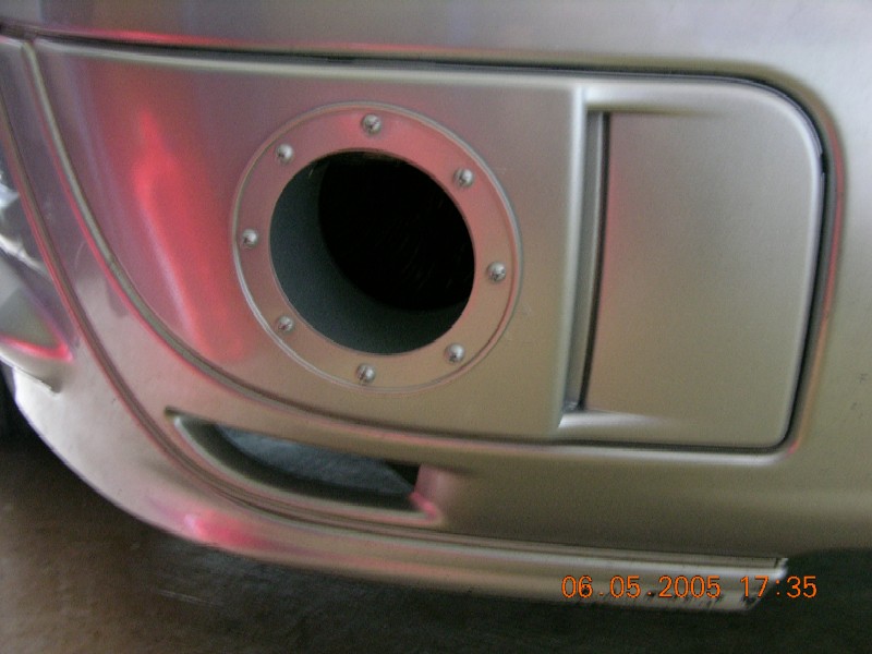

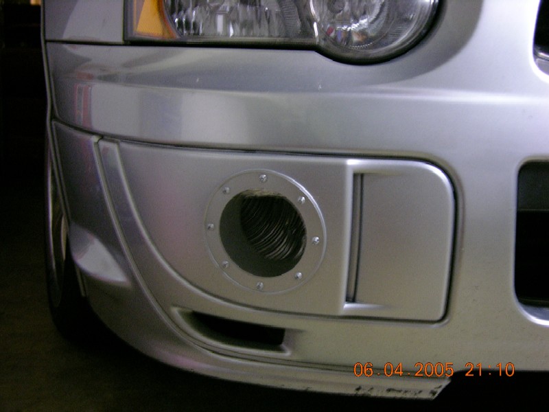

Here are some pics...
Just took them...
Attached Thumbnails Cold Air Infusion!-cold-air-infusion-1.jpg   Cold Air Infusion!-cold-air-infusion-2.jpg   Cold Air Infusion!-cold-air-infusion-3.jpg

I Think the pictures are making me look good...
Thanks guys...
Really though...the engine bay, after moving, is much cooler...no extra noise that I am aware of...
Riding in the rain is no problem...it's not hooked straight up to the intake or anything...no suction, the water droplets will have a hell of a time making their way through that tube...the tube because of it's design ( it is not the most aerodynamic piece of equipment...but it does let the cooler air inside the bay...
rats...I'm sure if rats wanted to get into an engine bay, it could easily do that regardless of this tube...cats use to do that during the winters in Anchorage...the strays would try to warm up...sometime they would get...yeah, it's gross...
The reason I didn't use any screening (yet) was because it creates such oppositional forces to the movement of air (and I couldn't find what I was looking for)...I was noticing, that even during a fairly windy day here in Kaneohe, if I stepped outside...it would be blowing, but inside, even with a clear path for the wind to get through....I would feel only a fraction of the force through our window screen...I can easily attach something back there though...
Let me know if anyone wants to do this...I made a few mistakes that I could help you avoid if you should plan this...
Brent
