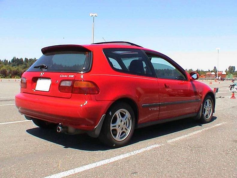

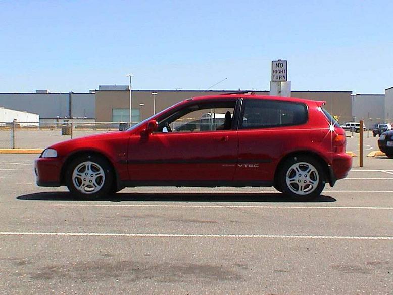

I wouldn't necessarily stay away from the 88's. The only real difference as far as I know is that the rear LCA is a stamped steel unit like that of the 97-01 ITR. You can swap them out for the 89-95 Civics or the 90-01 Integras if you really want to. But with the 88 LCA, you can run the same Tein shocks meant for the ITR.
But IMO, I'd rather get a 92-95 Civic hatch. Sure they are played out but they are hands down the best civic out there, IMO. I used to have a 95 Si with a 97 ITR motor, CTR trans + 98+ JDM ITR FD. It also had a JDM 4-1 header and the whole OEM JDM look (headlights, corners, side markers, front lip, stickers, power folding mirrors, guage cluster, flare, power windows, locks, etc). That car was a blast to drive and I regret selling it. So I am on the lookout for a 94-95 Si so that I can build another one.
Oh, BTW, an FWD with a LSD makes a HUGE difference. I refuse to own a FWD w/o one and all of the hybrids and 'special' hondas I've owned had them. I personally don't like FWD for racing since don't really consider it a 'pure' sports car layout. But you can't beat the reliability, practicality, and fuel economy of a typical FWD Honder. A FWD hybrid Civic stripped down with full susp and 13x7 or 14x7 rubber can lay down some serious hurt at the auto-x or road race.
