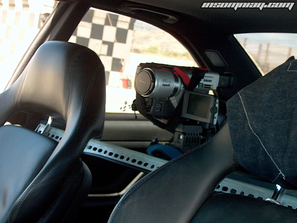

here's a pic of one i made years ago...someone thought it was cool, so i guess he posted it on his website...
cost me about 10 bucks to make, not including the cost of the tripod mount...
just got some angle stock from lowes, some 3/8" threaded rod, and washers and wing nuts...
i wasnt able to use regular u bolts, as they werent shallow enough...so i made my own u bolts with the threaded rod...i seen some variations where no tripod head was used, but with they way my seats are angled, the camera would be pointing to the headliner...so the tripod head mounts directly to my mount, and it's pretty cool, as i can adjust it for the PERFECT picture...or make it face the rear so i can see all the cars i pass ...
since it spans the width of the 2 headrests, the chances of the bolts failing and the contraption getting under the brake pedal is slim...it'll just fall into the rear passenger area...i also backed it up with some long velcro straps which is a secondary safety measure to secure the camera from coming off the mount...of course if you copy what i did, and it fails and the camera rolls under your brake pedal at the end of the straightaway and you die a horrible firey death, it's not my fault...also note, some racing associations will not allow this kind of mickey-mouse camera mount- but every venue here let mine pass...
the picture comes out pretty nice, it is a little shaky at times, but tolerable (yes, it had image stabiliztaion)...and since then, i've used a smaller/lighter camera which helps it a bit...one suggestion though, use a external mic, and place it in the engine bay or in the trunk near the exhaust...at an autocross, it's work good and you can hear the engine sounds okay, but at a track day all i'd hear would be wind noise...
after a while, the novelty of it wears off, and i never use it anymore...and no i wont sell it to you, but i can help you make your own if you want

Cool idea but won't work on a newer WRX or STI

doh, forgot wont work on the seats...what about rear headrests? do they have posts? are there even rear headrests in the wrx/sti???
at least i know it'll work on the older RSs...
if not, then i think bdrifts harnessbar is the way to go...
Old Dec 8, 2004 | 07:52 PM
silver satin's Avatar
Posts: 3,298
It would be perfect on a 02/03 they still had headrests... I kinda wish the 04/05 did it would be easier to make your own mount..
