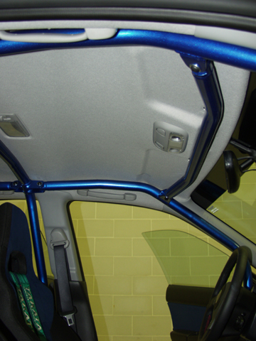

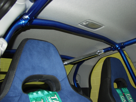

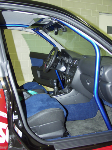

cusco 6 pt. roll cage = $841.90 (beforrrrre shipping)
why not?
oh, and you forgot to add everything up for us
Attached Thumbnails Am I missing anything...-front.jpeg   Am I missing anything...-centerroof.jpeg   Am I missing anything...-frontroof.jpeg

Old Oct 21, 2004 | 05:50 PM
oldmansan's Avatar
Posts: 2,176
From: Southern California
Well,
I doubt the harness bar will clear the Cusco roll cage. You can look at my harness bar and compare it to the cage pic (Sparco harness bar is really by Speedware, not Sparco). I'm not familiar with the harness you're looking at. Not sure you need a 5-point, and if so I'd probably go six point. I've had one guy on NASIOC say he runs the Hotchkis sway bar with the STI pink bits, but never seen a pic. That would suck to find out they don't work with each other. The Hotchkis kit comes with heavy duty mounts, and I'd stay away from Perrin myself. I'll be happy to let you know why offline. That radiator is pricey, you can get good ones for $450. Brides aren't made in Japan anymore, Taiwan according to a good source. Also, I'd buy seats only to reduce weight. With a correctly cinched down harness, you won't be moving around. Why the clutch? I bought that SS clutch line and it had a leak, Adam at Z-1 will waranty it though (good guy to deal with). Never seen any evidence you need fuel rails. Plenty making goofy power on stock rails. I'd add brake ducts to your list. How about a front lower arm brace to lose the heavy u-brace? Aluminum skid plate? You're using Samco for most, use it for the intake also (again Perrin, I'll talk offline). Also, look for "package" prices to help lower your costs. Weight reduction. You should also add black paint under performance, the black cars are faster. Cool?
San
