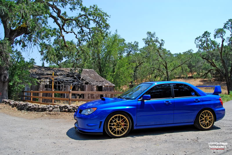

i am running VW BBS RC's on my car with no hubcentric rings and no problems... for about 25k now. Throw them on, make sure your lugs are tight and you'll be good.
pic for proof:

Would be best to have the hubcentric rings even though you CAN run without.
Just ensures no movement and makes it less likely to have lug damage.
The 3mm should be fine unless you have some kind of really exact measurement you're going for.
