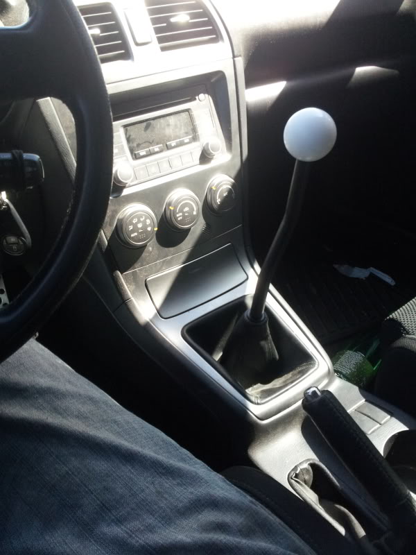

Old Sep 24, 2013 | 02:08 PM
queeg9k's Avatar
Posts: 6,849
From: Cheesesteakville
Originally Posted by de_engineered
It's funny how technically a lighter, longer shift arm makes more sense mechanically, vis being a lever and all that, but a short and heavy action just feels nicer. I've an OEM short shifter and it's well enough for me.
This feels right to me
