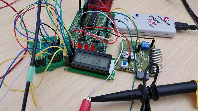

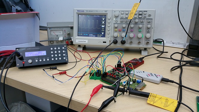

Made some solid progress the last week or so. Prototype is pretty much completed utilizing a 8x2 LCD to display data. In addition, I've also developed an Android app as well, that communicates with the ECA via BT/BTLE for a more streamed line and cost effective solution.
Check out the youtube link below and let me know what you think. Next step is to finalize my hardware and perform a layout and do some final tweaks to the Android app. I'm also looking for a few beta testers as well to test out the 1st revision boards for some feedback and verification. PM me if you are interested in testing one (you'll receive a free ECA minus the flex fuel sensor for testing and providing your critical feedback!).
