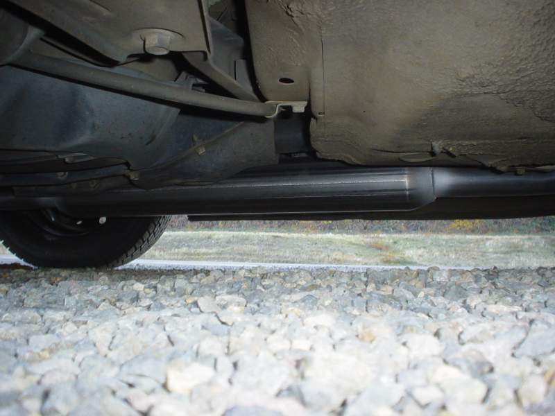

Okay... I FINALLY got my cat-back fabbed and installed... I've been holding onto a generic dual-tip 'straight-thru design' muffler I got off Ebay a few months ago, and I've been changing plans for a few weeks now.
I settled with 2 1/4 piping, and a MONSTER 30" stainless steel resonator (I didn't want it to be obnoxiously loud). I love the sound... With the borla headers and rallitek intake I have installed, it seems to have a really cool, low rumble- just as I was shooting for. I wish I had a way of recording a sound clip...
The fitment is near perfect (IMHO), and it couldn't be much more solid. I think the angle and position of the tips fit the line and cutout in the bumper quite nicely. I see this as one advantage of getting a custom cat-back rather than a pre-fab. Also, everything, (including the $75 magnaflow resonator, muffler, and kartboy bushings) only cost me around $250.
I originally wanted to paint the muffler and part of the tips black (and would still prefer it that way), but I never got around to that.
I guess now I'm in search of a high-flow cat section to make it a complete head-back exhaust
Pics...

He (muffler Mike) had the one I got in stock... Anyhow it is magnaflow part #14464. 14463, 14462, 14461, I believe, are just shorter- but this site doesn't specify the length. the 14464 is 30", that's all I know...
Here are some that are a little different, but would serve the same purpose...
http://www.ajusa.com/cgi-bin/magnafl...b172ab8deae55a
If you enter in the part # at the top of the page... here's the one I got ( I guess I coulda' saved some money by buying it myself, rather than through the muffler shop... only about $15 though, considering shipping.)
They really do seem to tone down the sound quite nicely- and they may even possibly make it a lower tone... because I can't see how mine could sound much lower.
