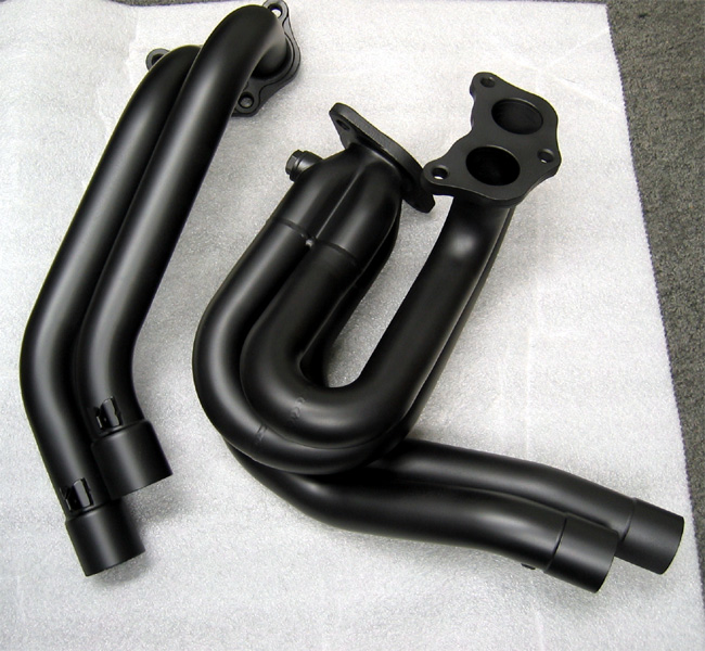

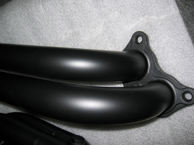

I wrapped mine and it took forever. I did wrap each one to the collector. That could be why it took me so long. I ended up cutting it off before I installed it. I had it cera-metallic coated by Crucial racing. I'll see if I can dig up a pic.
Old Dec 6, 2005 | 07:57 PM
ipozestu's Avatar
Posts: 7,570
From: Subabrew Crew
Car Info: Broken Subarus
Here are the pictures of my Gruppe-s V2 header coated by Crucial Racing
